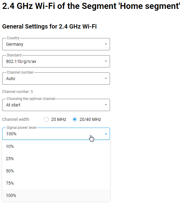

Changing the signal power level in wireless network settings
In the router's web interface, in the advanced settings for the Wi-Fi wireless network, there is a parameter called Signal power level.
This parameter changes the Wi-Fi signal power emitted by the Wi-Fi transmitter. The available preset values are indicated as a percentage of the maximum power: 10%, 25%, 50%, 75% and 100% (default).
At 100%, we achieve the maximum nominal power of routers, which is 20 dBm.
When this parameter is changed, the following attenuation occurs:
  • 75%: nominal power is reduced by 1 dBm and is 19 dBm;
  • 50%: nominal power is reduced by 3 dBm and is 17 dBm;
  • 25%: nominal power decreases by 6 dBm and is 14 dBm;
  • 10%: nominal power decreases by 9 dBm and is 11 dBm.
The measurement error when obtaining these values is ±1 dBm.
