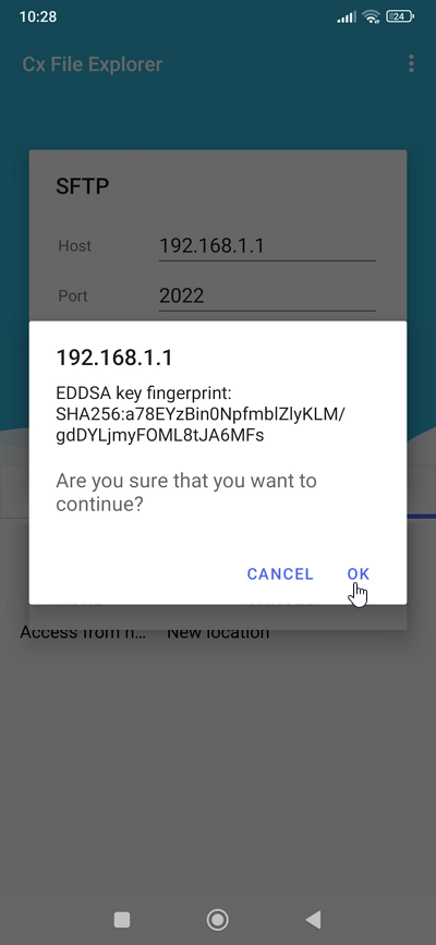

Run the Cx Explorer application on your Android mobile device.
Add a connection on the Network tab.
Go to the Remote tab and select the SFTP protocol.
Specify the router's IP address in the Host field (for access from the Internet, it is a WAN IP address, and for access from the local network, it is a LAN IP), the SSH port number, and the username and password of the router user account.
To connect to the router via third-party applications, we recommend creating a separate user account, only allowing access to the SFTP server. For security reasons, do not use the router's administrator account; specify a user account with restricted rights.
Press OK to continue.
If the connection is successful, you will see the folders and files on the USB drive.
