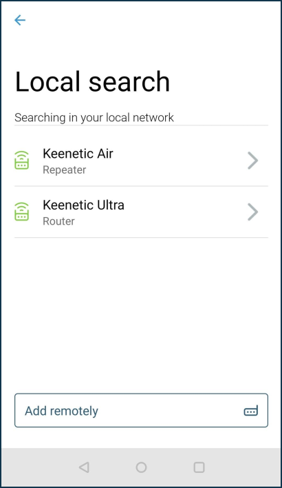

On the 'Local search' screen, click 'Add remotely'.

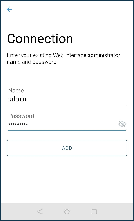

To connect to the Keenetic, use the same router administrator name and password as the web interface. Then click 'Add'.
On successful connection to the router, it will be added to the application.
