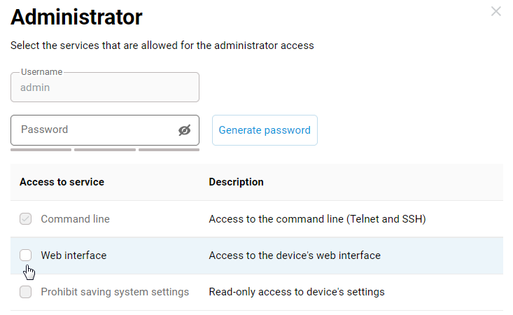

Question: Access to the Web interface service was disabled for the Administrator (admin) account in the Users and access menu by mistake.
As a result, access to the router's web interface has been lost. How can I restore it without resetting the router to factory defaults?

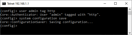

Answer: You cannot disable access to the command-line interface for the admin account so that you can restore the setting from the command-line interface (CLI) of the router with the following commands:
user admin tag http
system configuration save
Access to the web interface for the admin user will be restored.
