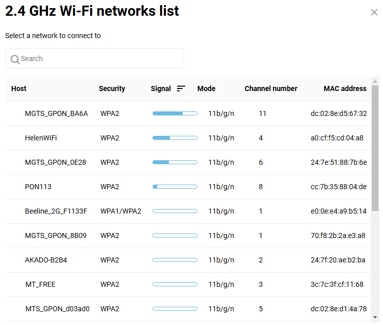

Connect to the web interface, go to the 'Wireless ISP' page, and click 'Scan for a network'.
You will see the available Wi-Fi networks within the range of the Keenetic in the displayed window.
The 'Channel number' column shows the channel numbers on which the neighbouring access points are running. The 'Signal' column shows the wireless signal level (power).

In the example above, you can see that there is a free channel 6
in the radio air and in this case, you should use this channel.

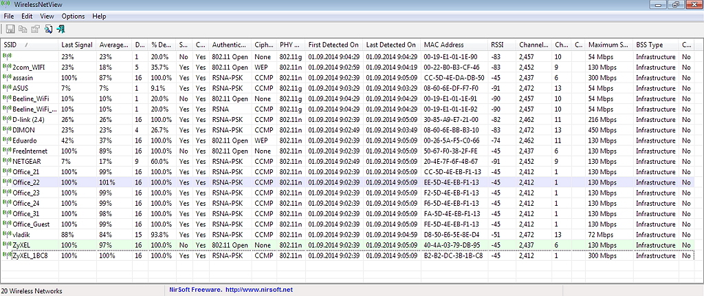

WirelessNetView

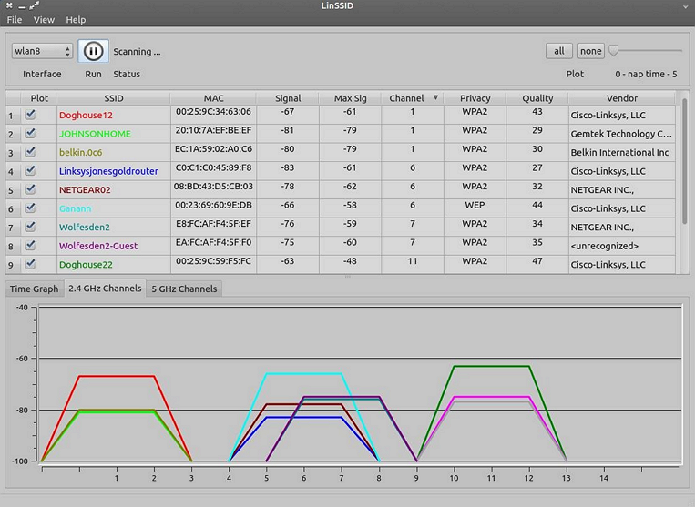

LinSSID (for Linux OS)
