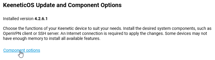

In the web interface go to the 'General System Settings' page.
To add or remove components, press 'Component options'.

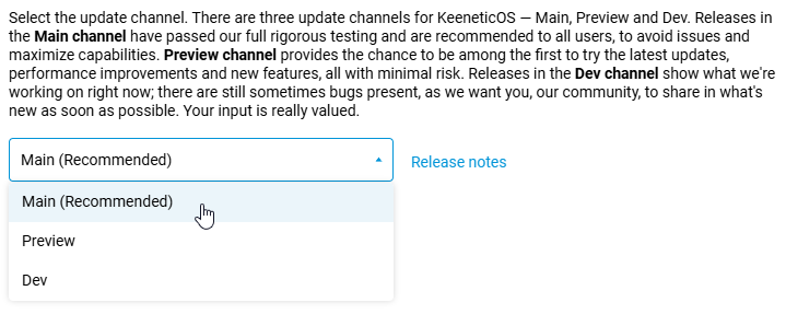

, the ability to select the KeeneticOS update channel has been added. There are3 channels
available:Main (Recommended): Updates in this channel have been fully tested and are recommended for installation to all users. Official releases are published about every two months.
Preview: By choosing this channel, you can be one of the first to experience the latest updates, performance improvements and new features with minimal risk. Preview versions are released twice a month.
Dev: The test channel is updated weekly and shows our community what we are working on right now. Test builds may contain errors.
Be careful when installing Dev builds! Before installing the KeeneticOS version from the Dev channel, it is recommended to make a backup copy of the current router configuration by saving the startup-config.txt file and the firmware file with the current set of operating system components installed on your Keenetic router. This will allow you to quickly restore the device configuration to its previous state if necessary. Refer to the Updating KeeneticOS by a system file article.
With the KeeneticOS upgrade channel selected, proceed to select the components you need.

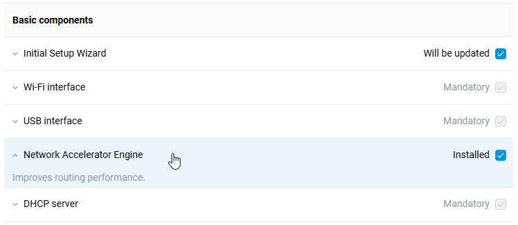

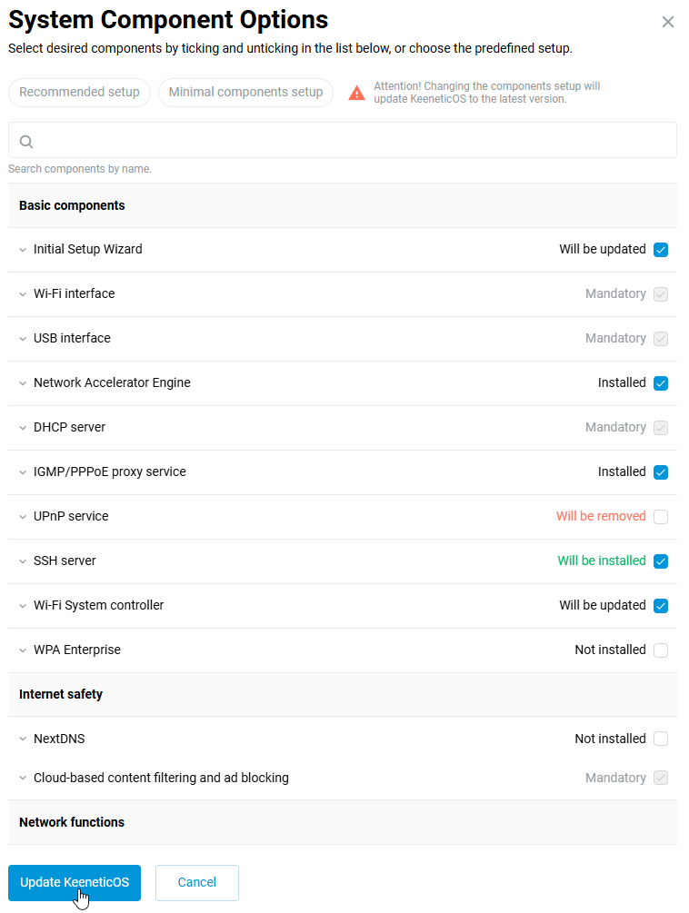

In the 'Systems Component Options' window, tick the necessary components for installation and uncheck the unnecessary ones that will be removed.
If a component is required for other components to work, its check box will be shaded. This also applies to mandatory components that cannot be removed.
If a component is installed by default, but you do not know what it is responsible for, do not remove it.
The ability to install all components available for a particular model simultaneously, as well as their specific combinations, is not guaranteed.
To find out what a particular component is responsible for (to see a brief description), click on its name.
After selecting the required components, click 'Update KeeneticOS'.
After that, the process of downloading and installing the components to the router will begin.
