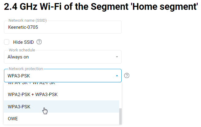

WPA3-PSK and OWE configuration is available in the router web interface in the 2.4 and 5GHz 'Wireless Network' settings on the 'My Networks and Wi-Fi' page. Locate the 'Network protection' drop-down and select the appropriate algorithm for your network.
To use the new WPA3-PSK and OWE network protection mechanisms, the connected device must support these algorithms in the driver of its radio module.

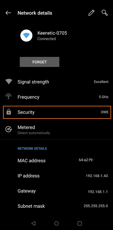

Below are some examples of connection on a Oneplus 6 smartphone (Android 9).
WPA3-PSK network protection (SAE):
OWE open network protection:
