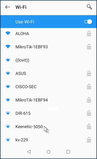

  4. Connect your mobile device to the router's Wi-Fi network.
    The Wi-Fi network name and password for the connection can be found on the device's bottom label. For example:
    Switch on the Wi-Fi network on your mobile device, and in the list of available networks, find your network whose name is on the label and click on it. In our example, this is the Keenetic-5050 network.
