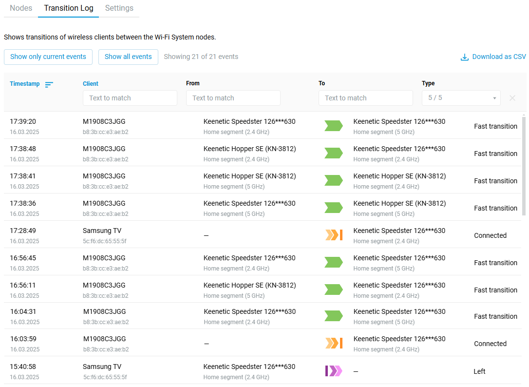

The 'Transition log' tab displays transitions of wireless devices between the Wi-Fi System members. The following events are registered:
Connection;
Left;
Transition (standard transition without 'accelerators', the client disconnected from one point and connected to another);
PMK cache transition (fast transition using PMKID cache, Pairwise Master Key Identifier);
Fast transition (the fastest transition with 802.11r and FT mode).
When the transition log is overflowed, you can use the filter.
