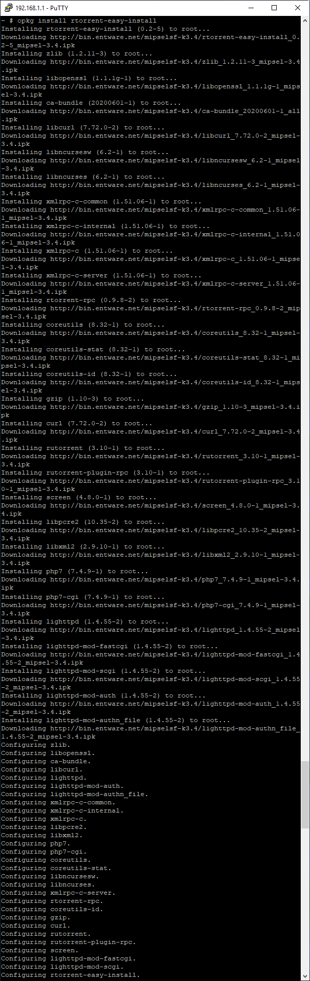

  2. Install the rtorrent-easy-install package.
    Run the opkg install rtorrent-easy-install command:
    / # opkg install rtorrent-easy-install
    Installing rtorrent-easy-install (0.2-3a) to root...
    Downloading http://bin.entware.net/mipselsf-k3.4/rtorrent-easy-install_0.2-3a_mipsel-3.4.ipk
    Installing rutorrent-plugin-rpc (3.8-1) to root...
    Downloading http://bin.entware.net/mipselsf-k3.4/rutorrent-plugin-rpc_3.8-1_mipsel-3.4.ipk
    Installing rutorrent (3.8-1) to root...
    Downloading http://bin.entware.net/mipselsf-k3.4/rutorrent_3.8-1_mipsel-3.4.ipk
    Installing rtorrent-rpc (0.9.7-1) to root...
    Downloading http://bin.entware.net/mipselsf-k3.4/rtorrent-rpc_0.9.7-1_mipsel-3.4.ipk
    Installing libcurl (7.61.0-3) to root...
    Downloading http://bin.entware.net/mipselsf-k3.4/libcurl_7.61.0-3_mipsel-3.4.ipk
    Installing libopenssl (1.0.2p-1) to root...
    Downloading http://bin.entware.net/mipselsf-k3.4/libopenssl_1.0.2p-1_mipsel-3.4.ipk
    Installing zlib (1.2.11-2) to root...
    Downloading http://bin.entware.net/mipselsf-k3.4/zlib_1.2.11-2_mipsel-3.4.ipk
    Installing ca-bundle (20180409-3) to root...
    Downloading http://bin.entware.net/mipselsf-k3.4/ca-bundle_20180409-3_all.ipk
    Installing libtorrent (0.13.7) to root...
    Downloading http://bin.entware.net/mipselsf-k3.4/libtorrent_0.13.7_mipsel-3.4.ipk
    Installing libsigcxx (2.5.4-1) to root...
    Downloading http://bin.entware.net/mipselsf-k3.4/libsigcxx_2.5.4-1_mipsel-3.4.ipk
    Installing libncursesw (6.1-1) to root...
    Downloading http://bin.entware.net/mipselsf-k3.4/libncursesw_6.1-1_mipsel-3.4.ipk
    Installing xmlrpc-c-server (1.39.13-2) to root...
    Downloading http://bin.entware.net/mipselsf-k3.4/xmlrpc-c-server_1.39.13-2_mipsel-3.4.ipk
    Installing xmlrpc-c (1.39.13-2) to root...
    Downloading http://bin.entware.net/mipselsf-k3.4/xmlrpc-c_1.39.13-2_mipsel-3.4.ipk
    Installing xmlrpc-c-internal (1.39.13-2) to root...
    Downloading http://bin.entware.net/mipselsf-k3.4/xmlrpc-c-internal_1.39.13-2_mipsel-3.4.ipk
    Installing xmlrpc-c-common (1.39.13-2) to root...
    Downloading http://bin.entware.net/mipselsf-k3.4/xmlrpc-c-common_1.39.13-2_mipsel-3.4.ipk
    Installing coreutils-stat (8.23-3) to root...
    Downloading http://bin.entware.net/mipselsf-k3.4/coreutils-stat_8.23-3_mipsel-3.4.ipk
    Installing coreutils (8.23-3) to root...
    Downloading http://bin.entware.net/mipselsf-k3.4/coreutils_8.23-3_mipsel-3.4.ipk
    Installing coreutils-id (8.23-3) to root...
    Downloading http://bin.entware.net/mipselsf-k3.4/coreutils-id_8.23-3_mipsel-3.4.ipk
    Installing gzip (1.9-1) to root...
    Downloading http://bin.entware.net/mipselsf-k3.4/gzip_1.9-1_mipsel-3.4.ipk
    Installing curl (7.61.0-3) to root...
    Downloading http://bin.entware.net/mipselsf-k3.4/curl_7.61.0-3_mipsel-3.4.ipk
    Installing screen (4.6.2-1) to root...
    Downloading http://bin.entware.net/mipselsf-k3.4/screen_4.6.2-1_mipsel-3.4.ipk
    Installing libncurses (6.1-1) to root...
    Downloading http://bin.entware.net/mipselsf-k3.4/libncurses_6.1-1_mipsel-3.4.ipk
    Installing php7-cgi (7.2.9-1) to root...
    Downloading http://bin.entware.net/mipselsf-k3.4/php7-cgi_7.2.9-1_mipsel-3.4.ipk
    Installing php7 (7.2.9-1) to root...
    Downloading http://bin.entware.net/mipselsf-k3.4/php7_7.2.9-1_mipsel-3.4.ipk
    Installing libxml2 (2.9.8-3) to root...
    Downloading http://bin.entware.net/mipselsf-k3.4/libxml2_2.9.8-3_mipsel-3.4.ipk
    Installing lighttpd-mod-fastcgi (1.4.49-2) to root...
    Downloading http://bin.entware.net/mipselsf-k3.4/lighttpd-mod-fastcgi_1.4.49-2_mipsel-3.4.ipk
    Installing lighttpd (1.4.49-2) to root...
    Downloading http://bin.entware.net/mipselsf-k3.4/lighttpd_1.4.49-2_mipsel-3.4.ipk
    Installing lighttpd-mod-scgi (1.4.49-2) to root...
    Downloading http://bin.entware.net/mipselsf-k3.4/lighttpd-mod-scgi_1.4.49-2_mipsel-3.4.ipk
    Installing lighttpd-mod-auth (1.4.49-2) to root...
    Downloading http://bin.entware.net/mipselsf-k3.4/lighttpd-mod-auth_1.4.49-2_mipsel-3.4.ipk
    Installing lighttpd-mod-authn_file (1.4.49-2) to root...
    Downloading http://bin.entware.net/mipselsf-k3.4/lighttpd-mod-authn_file_1.4.49-2_mipsel-3.4.ipk
    Configuring zlib.
    Configuring libopenssl.
    Configuring ca-bundle.
    Configuring libcurl.
    Configuring lighttpd.
    Configuring lighttpd-mod-authn_file.
    Configuring xmlrpc-c-common.
    Configuring xmlrpc-c-internal.
    Configuring xmlrpc-c.
    Configuring libxml2.
    Configuring php7.
    Configuring php7-cgi.
    Configuring coreutils.
    Configuring coreutils-stat.
    Configuring libsigcxx.
    Configuring libtorrent.
    Configuring libncursesw.
    Configuring xmlrpc-c-server.
    Configuring rtorrent-rpc.
    Configuring coreutils-id.
    Configuring gzip.
    Configuring curl.
    Configuring rutorrent.
    Configuring rutorrent-plugin-rpc.
    Configuring libncurses.
    Configuring screen.
    Configuring lighttpd-mod-fastcgi.
    Configuring lighttpd-mod-scgi.
    Configuring lighttpd-mod-auth.
    Configuring rtorrent-easy-install.

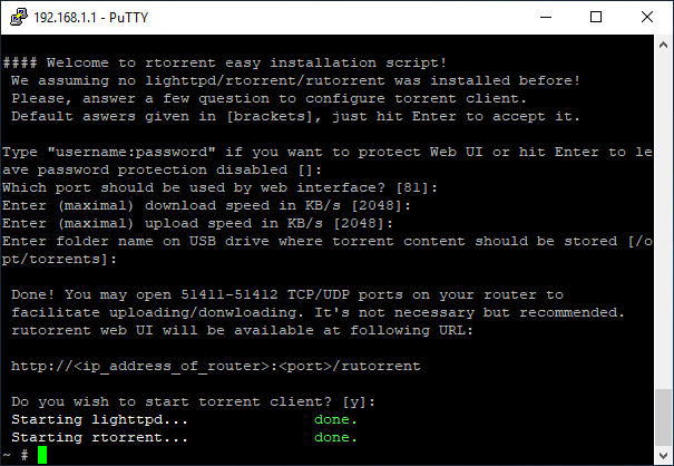

  3. When you install the package, you will be immediately prompted to configure basic features.
    You can set your login/password, port, upload/download speed, path for downloaded torrent files:
    Type "username:password" if you want to protect Web UI or hit Enter to leave password protection disabled []: set your username:password, e.g. myhome:mytorrent
    Which port should be used by web interface? [81]: default port is 81, you can set any free port.
    Enter (maximal) download speed in KB/s [2048]: default speed is 2048, you can set your own value.
    Enter (maximal) upload speed in KB/s [2048]: default speed is 2048, you can set your own value.
    Enter folder name on USB drive where torrent content should be stored [/opt/torrents]: specify the path where torrent files will be downloaded. It is better to install NTFS partition, for example we have created a partition with NTFS file system called FILES, in it we have created download directory, specify the path: /tmp/mnt/FILES/download
    #### Welcome to rtorrent easy installation script!
    We assuming no lighttpd/rtorrent/rutorrent was installed before!
    Please, answer a few question to configure torrent client.
    Default aswers given in [brackets], just hit Enter to accept it.
    Type "username:password" if you want to protect Web UI or hit Enter to leave password protection disabled []: test:test
    Done! You may open 51411-51412 TCP/UDP ports on your router to
    facilitate uploading/donwloading. It's not necessary but recommended.
    rutorrent web UI will be available at following URL:
    http://<ip_address_of_router>:<port>/rutorrent
    Do you wish to start torrent client? [y]:
    Starting lighttpd... done.
    Starting rtorrent... done.

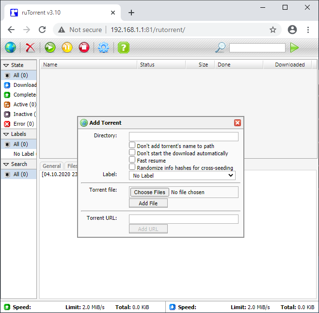

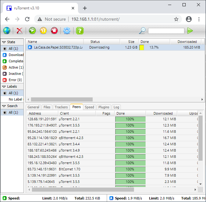

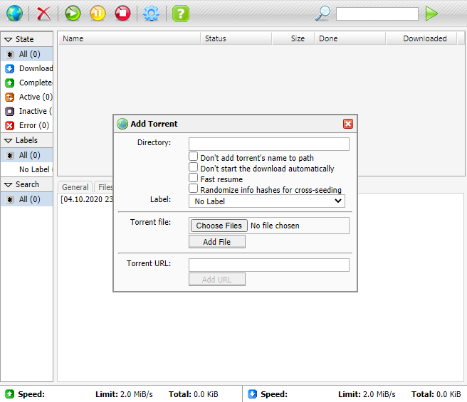

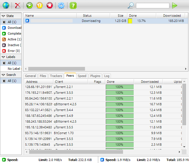

  7. Go to the rTorrent web interface at http://192.168.1.1:81/rutorrent/, configure and check how it works:
