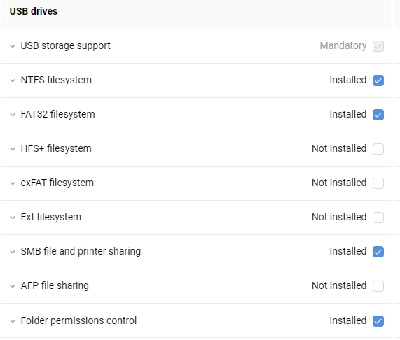

  1. Before connecting the USB flash drive to the Internet hub, ensure that the system components required to work with the USB flash drive are installed on the device. This can be done on the 'General System Settings' page in the 'KeeneticOS Update and Component Options' section by clicking 'Component options'.
    In particular, when connecting a USB drive with an NTFS file system, the NTFS filesystem component must be installed, and when connecting a USB drive with a FAT32 file system, the 'FAT32 filesystem' component must be installed.
    'Folder permissions control' component allows you to set permissions for individual directories located on the USB drive, while the 'SMB file and printer sharing' component provides access to USB drives and printers for PCs with Windows OS.

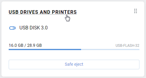

  2. Connect a USB drive to a USB port of the router. Keenetic will automatically recognize and install compatible storage. If a drive contains volumes, they will be mounted automatically.
    Make sure that the system has detected USB storage. On the 'USB drivers and printers' section of the 'System dashboard' page, you should see a connected drive record.
    If the drive is not recognized, connect the drive to your computer and check for errors in the file system. For more information, refer to the What to do if the router cannot see a connected USB drive article.

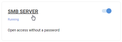

    Click on 'USB drives and printers' to go to the 'Applications' page. Here you will see the 'SMB server' panel. SMB server is enabled by default. The operating system of the router supports CIFS/SMB (SMB v1/2/3) protocols. Click 'SMB server' to configure the file server and to share folders.

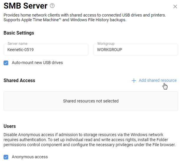

  3. In the 'Basic Settings' option, 'Auto-mount new USB drives' is enabled by default. This means that the newly-plugged drive will be automatically added to the system. You can change the server's name in the 'Server name' field, identifying the router in a local network (NetBIOS name). If you want the router to be visible in Network Neighborhood, you need to specify the group name to which all other PCs belong in the 'Workgroup' field.

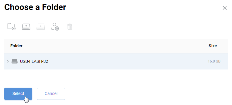

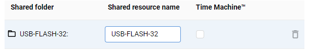

    To add and configure a shared folder, click on 'Add shared resource'. A window opens with a built-in file browser, where you have to specify a certain folder on the USB drive, which will be shared, and then click the Select button. In our example, we selected the root directory to provide access to all folders on the drive.
    After selecting the shared folder, you need to go back to the 'SMB server' page. The name of the shared folder will be displayed automatically in the 'Shared resource name' block, but you can set its name manually.
    The 'Anonymous access' option (access without authentication) is enabled by default in the 'Users' section. Access to the file server from computers and mobile devices running Android, Microsoft Windows, Apple OS X, and iOS is open by default to all users of the home network without authentication. You can change this setting and add the 'Folder permission control' component to restrict users' access to folders. Additional info you can find in the article Folder permissions control on a USB drive.

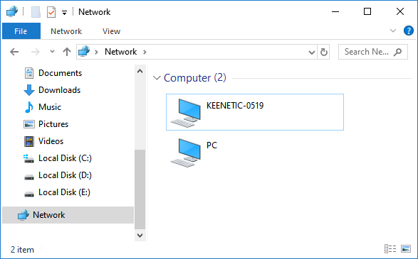

  4. Below is an example of configuring the network access to USB storage from Windows. Use 'Run' or open the 'Explorer' file manager. Type the local IP address of the Keenetic in the address bar,  with \\ in the beginning (in our example, it's \\192.168.1.1). You can use network name of the Keenetic, example \\Keenetic-0519.
    If the router is in the same workgroup as other computers on your home network, you can access the USB drive through your 'Network Neighborhood' (Network).
    If you don't see the name of your router on your computer in the network, refer to the article What to do if the USB drive cannot be accessed over the network or the router does not appear on the Windows network.
