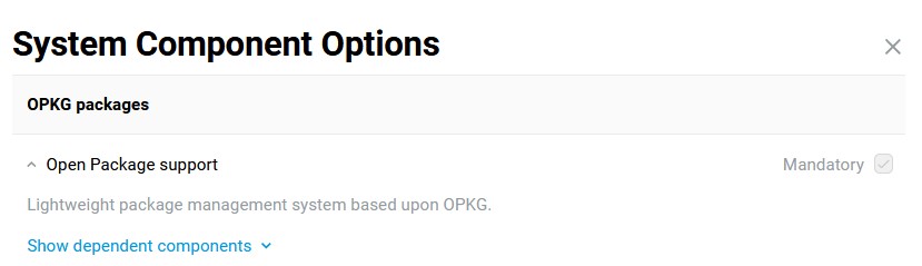

OPKG is a freeware package manager for embedded systems. To work with the package manager, you need to install the Open Package support system component in the router. This can be done on the General System Settings page in the KeeneticOS Update and Component Options section by clicking on the Component options.

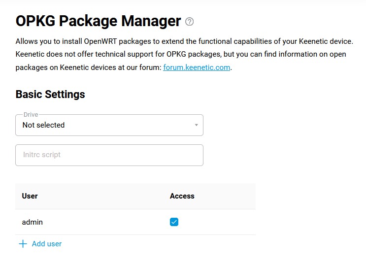

After the component is installed, the OPKG page will appear in the web interface.

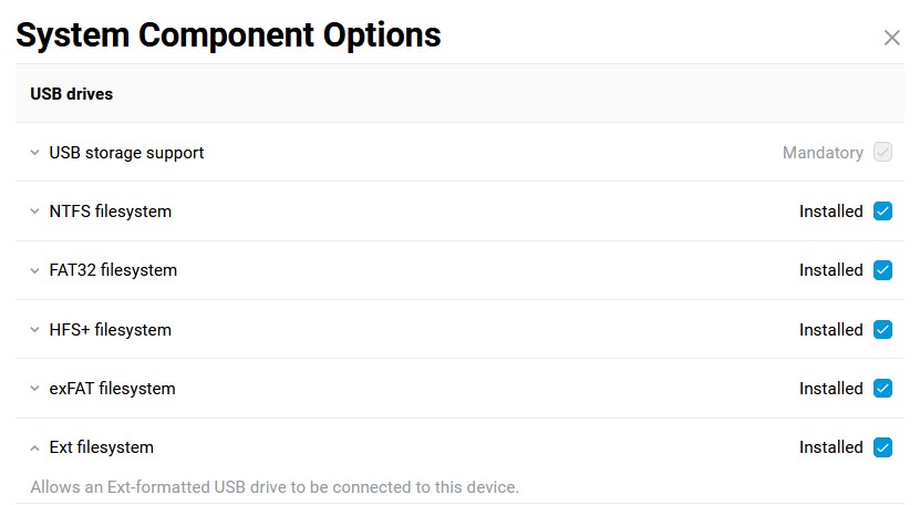

To use OPKG packages, you need a USB drive connected to the router. The drive must be formatted in the EXT file system. We recommend using the current and up-to-date journaled EXT4 file system.
The Ext filesystem component must be installed in your Keenetic router for the drives to work with EXT4. You can check this on the General System Settings page under KeeneticOS Update and Component Options by clicking on Component options.
