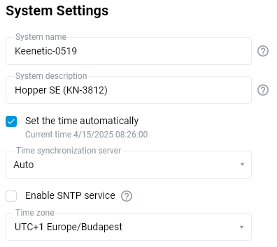

The 'Set the time automatically' checkbox is enabled by default. This option works only when the router is connected to the Internet. The device starts trying to synchronize with one of the pre-installed pool.ntp.org NTP servers as soon as it is turned on and sends a request via NTP protocol every 10 seconds until it successfully synchronizes. The internal counter then counts down the time, and the next synchronization will take place after 7 days by default (with the router running non-stop).
In the 'Time zone' field, you can select the time zone and the time offset according to UTC (Universal Time Coordinated).
The list of time zones shows Standard time. Standard time refers to the time that is valid in winter. It specifies the time offset without taking Daylight saving time (DST) into account. The router's operating system calculates daylight saving time in the various regions and correctly sets the current time.

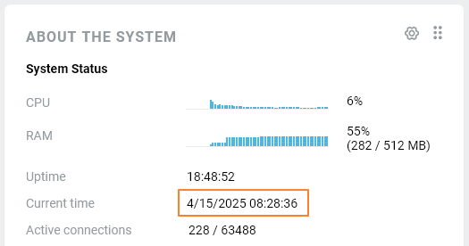

We do not recommend disabling the 'Set the time automatically' option, as it affects some mechanisms in the device. For example, the operation of the schedule depends directly on the current time set in the router. Ensure that you enabled this option on the 'General System Settings' page, in the 'System Settings' section, and that you chose the 'Time zone' correctly. You can see the current time on the 'System Dashboard' page in 'About the system' section.

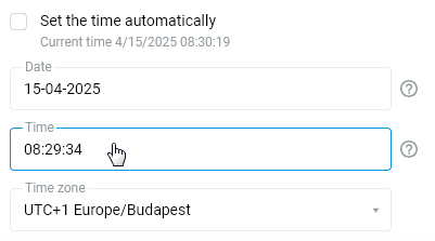

To set the date and time manually, turn off the 'Set the time automatically' option. You will see two fields, 'Date' and 'Time', where you can choose the date in the 'DD-MM-YY' format and the time in the 'HH:MM:SS' format, respectively. Then save the settings.

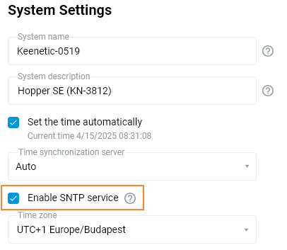

As of KeeneticOS 3.9, a SNTP (Simple Network Time Protocol) server has been added to ensure that your applications and devices on the Keenetic local network are time synced. A checkbox has been added to the 'General System Settings' page, enabling the local network's SNTP service.
You can also enable the SNTP server in private and protected segments via the CLI using the ntp master command.

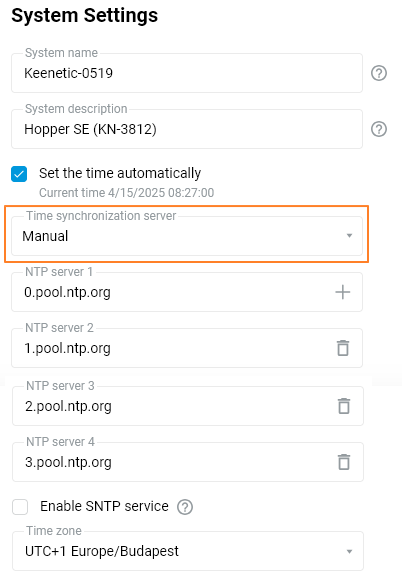

Please note that when the 'Time synchronization server' field is set to 'Auto', and the SNTP service is enabled, time synchronization will take place with the KeeneticOS cloud server.
