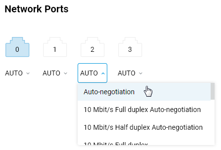

Сhanging the port's operating mode (speed and duplex parameters)
This option may be required for compatibility with network devices.
On the 'General System Settings' page in the 'Network Ports' section, you can manually set the operating mode for each network port. The Keenetic router's built-in Ethernet switch automatically detects connection speed and cable type (duplex mode) by default. If necessary, the speed/duplex settings on the Ethernet port can be set manually.

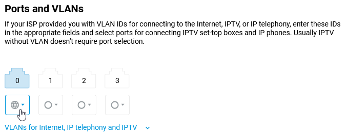

Setting one of the LAN ports as a WAN port
You can assign a WAN port function to one of the free LAN ports.
Be sure to disconnect the ISP Internet cable from the router before changing the port role.

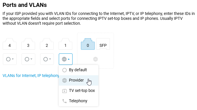

Go to the 'Ethernet Cable Connections to Internet' page, in the 'Ports and VLANs' section, select a free LAN port (in our example, it is port 1) and choose 'Provider', which will determine the operation of this port as a WAN port of the 'Provider' wired Internet connection.

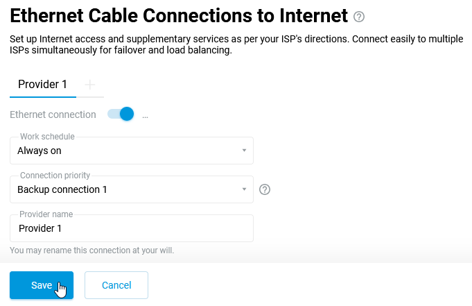

Save the setting and connect the ISP's network cable to this port.
Then make sure that Keenetic has received an IP address from your ISP (established a connection). On the 'System Dashboard' home page in the 'Internet' section, the IP address will be displayed in the same way as when the ISP cable is normally connected to the default WAN port.
Keenetic routers support multiple simultaneous connections (usually called Multi-WAN). For example, you can simultaneously connect two Internet Ethernet cables from different ISPs to the Keenetic and set up basic connection redundancy. All Keenetic routers, without exception, support Multi-WAN. For information on configuring it, see the article 'Using multiple ISPs: redundancy and multi-WAN'.

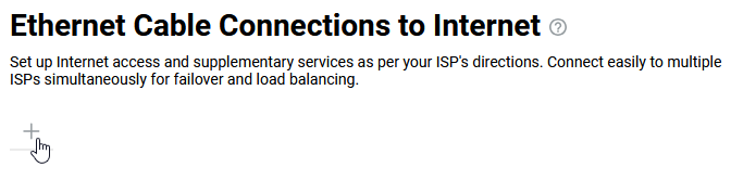

For models with an SFP slot, the setup will be slightly different. On the 'Ethernet Cable Connections to Internet' page, click on '+' (Add an ISP).

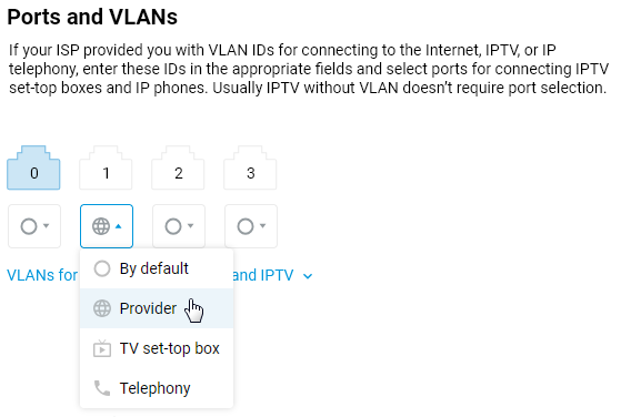

Then under 'Ports and VLANs', select a free LAN port (port 1 in our example) and set it to 'Provider', which will define this port to act as a WAN port.

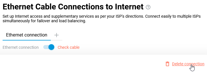

Since this example does not use the main WAN port '0' of the built-in switch (using an Internet connection via a USB modem), the wired connection to the ISP must be deleted. Go to the 'Ethernet Cable Connections to Internet' page and click 'Delete connection' (located at the bottom on the right).

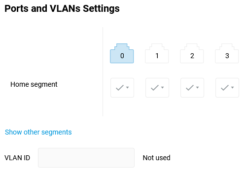

After that, the WAN port '0' will be automatically included in the Home segment, i.e. it will become a regular LAN port. You will be able to use it to connect home devices via Ethernet cable.
To check, connect the network device to the WAN port '0'. It should automatically obtain the IP address of the home network from the router.
