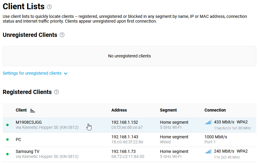

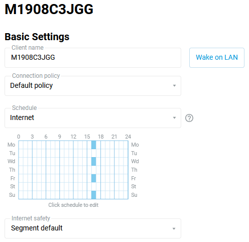

  1. First, register all devices on your home network. Then click on the entry of the device for which you want to create a work schedule.
    A window with settings will appear, wherein the Schedule field click Add schedule to create a new schedule or select an already created one. In our example, we have created a schedule to access the Internet on certain days of the week (Mo, Wd, Fr, Su) and only at certain times (from 16:00 to 17:00).
    You can find detailed information on setting up schedules in the 'A work schedule for connected devices' and 'A work schedule for network connections' articles.

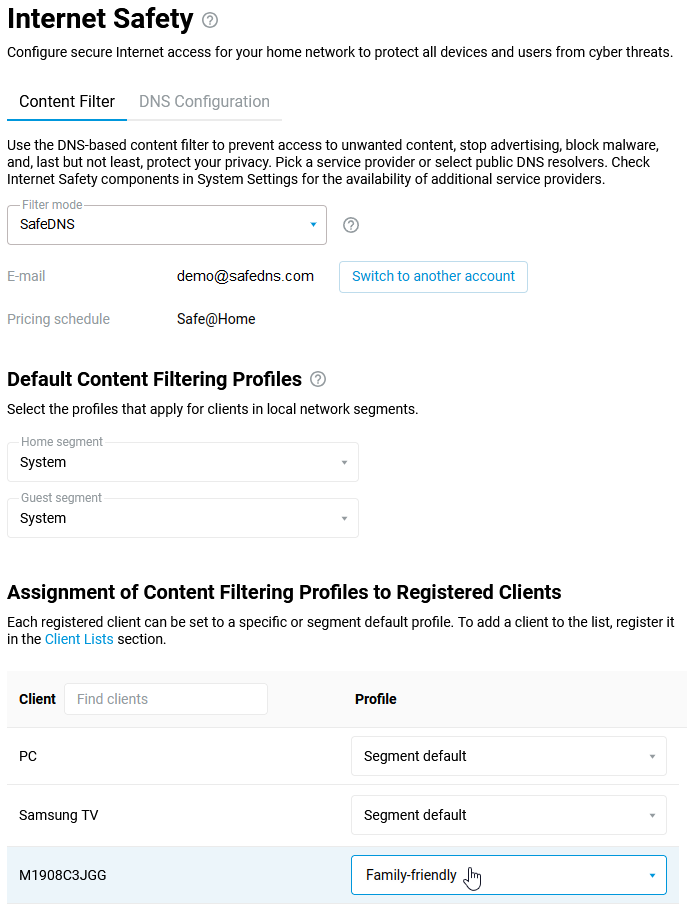

    In addition to schedules, we recommend enabling internet filters (ex. SafeDNS or NextDNS) to restrict access to dangerous sites and resources for adults. You can enable the Internet filter separately for each device in the home network by specifying the necessary policy.
    For example, the SafeDNS service allows you to set up filtering by categories (ban on visiting sites of certain topics), create 'Black' and 'White' access lists (block access to certain sites specified in the list, or grant access to certain sites only), keep statistics (list of visited and blocked sites), edit the blocking screen. We recommend you familiarize yourself with the full list of features of the Internet filter (and limitations of the free tariff) on the service's official site.

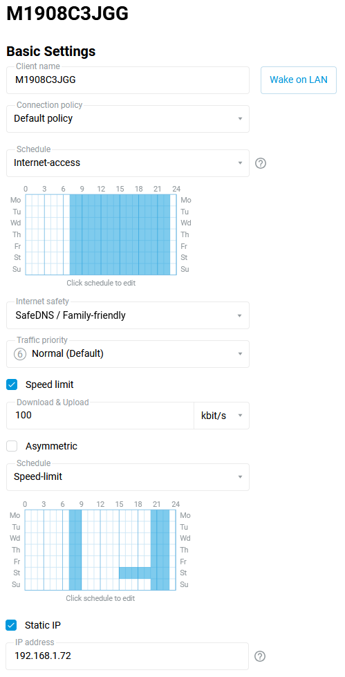

  2. Here is another example: we create an access schedule and a speed limit at certain hours.
    Suppose you need to set up a schedule for a child's smartphone:
    From Monday to Friday + Sunday, Internet access is allowed
    • from 07:00 to 09:00 with a speed limit of 100 kbps
    • from 09:00 to 20:00 with no restrictions
    • from 20:00 to 23:00 with a speed limit of 100 kbit/s
    Internet access is allowed on Saturday
    • from 09:00 to 15:00 with no restrictions
    • from 15:00 to 23:00 with a speed limit of 100 kbit/s
    Internet access is prohibited on all days of the week, from 23:00 to 07:00.
    To solve this task, you will need to create two schedules: one will indicate the entire allowed time range, and the other will indicate the time when the speed limit will work:
