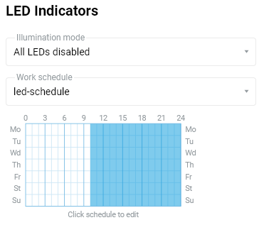

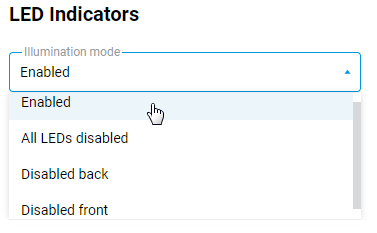

  1. The web interface, on the 'General System Settings' page, in the 'LED Indicators' section, provides the settings for controlling the LEDs located on the case of the device (this feature has been added in KeeneticOS 3.6).
    The following values are available for the 'Illumination mode' parameter:
    • Enabled
    • Disabled front
    • Disabled back
    • All LEDs disabled
    If necessary, you can set the LEDs (indicators) to turn off according to the specified time. To do this, refer to the 'Disabling all LEDs on schedule' manual.

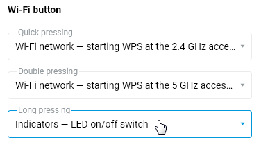

  2. In the web interface, on the 'General System Settings' page, under the 'The Functions of Device's Buttons and Indicators' section, you can assign the 'Indicators — LED on/off switch' action to the Wi-Fi or FN buttons.
    The first time the button is pressed, only the LEDs on the front panel are turned off.
    The second time only the LEDs on the back panel.
    The third time all the LEDs are turned off.
    The fourth time all the LEDs are turned back on, i.e. the state when all the LEDs are lit.
    After restarting the device, the light indication is restored to the factory preset when all the indicators are lit.
