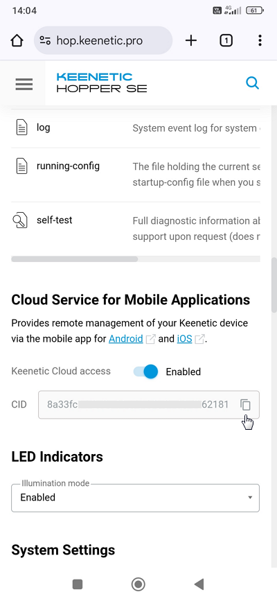

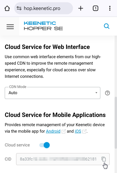

The Keenetic mobile application allows you to add a new Keenetic by CID. You can find the CID of your Keenetic in the web interface, on the General System Settings page, in the Cloud Service for Mobile Applications section.
To avoid mistakes when entering a CID, copy it to the clipboard.

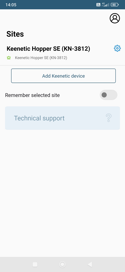

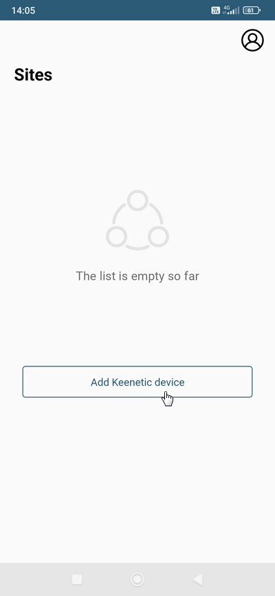

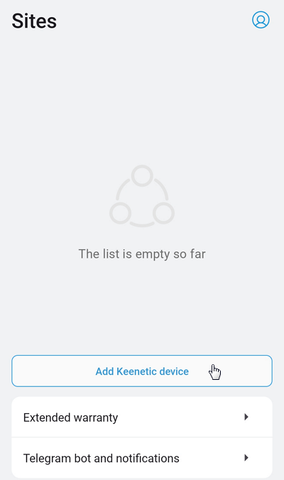

Start the Keenetic application and click Add Keenetic device on the Sites screen.
Before you start adding your Keenetic devices, make sure it is turned on and ready to use.

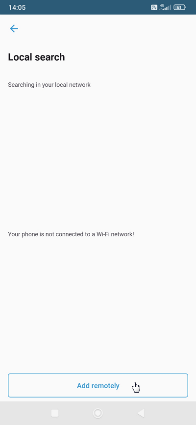

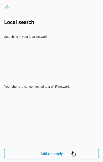

On the Local search screen, click Add remotely.

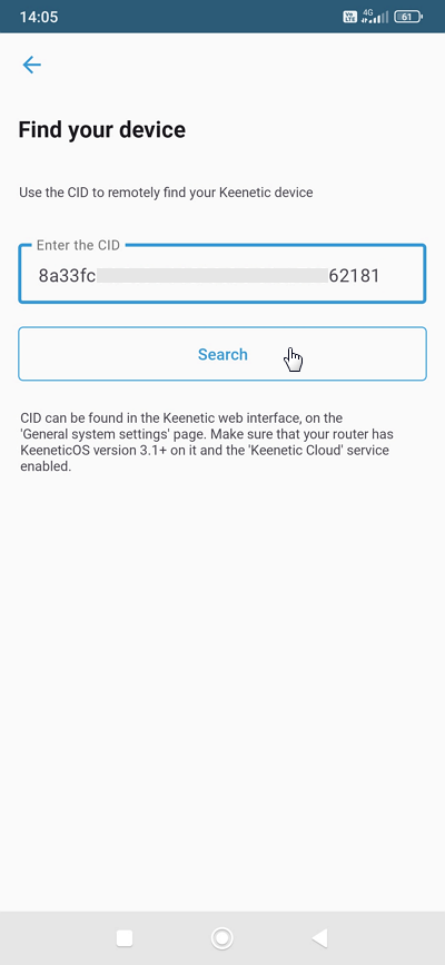

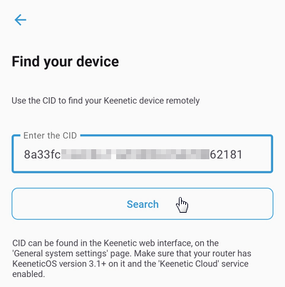

Enter the CID of your Keenetic or paste it from the clipboard and click Search.

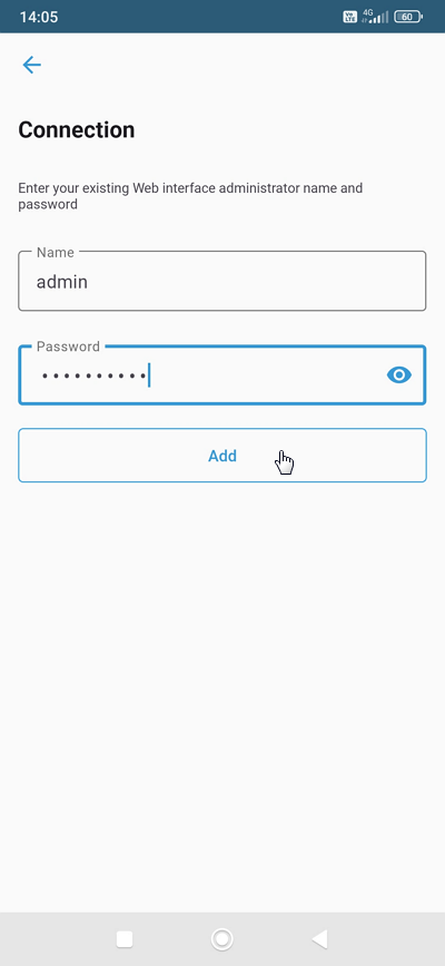

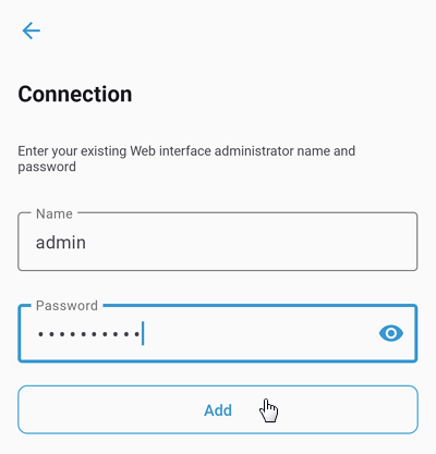

To connect to the Keenetic, use the same router administrator name and password as the web interface. Then click Add.

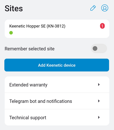

On successful connection to the router, it will be added to the application.
