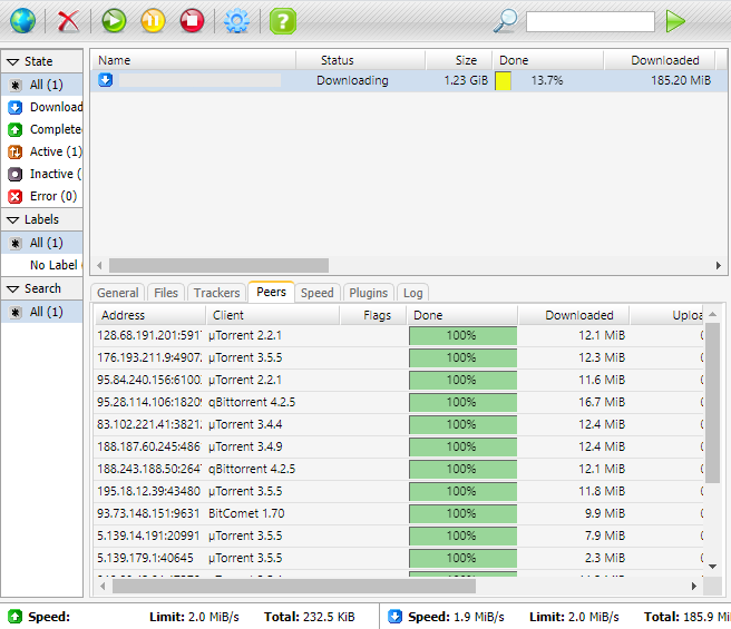

  12. Go to the rTorrent web interface at http://192.168.1.1:81/rutorrent/, configure and check how it works:
