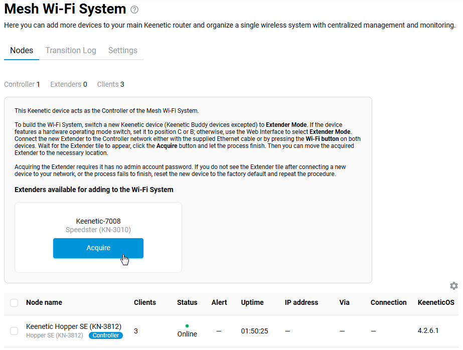

The Controller function is to be configured in the web configurator on the Mesh Wi-Fi System page. Once connected, the Extender will appear on the Devices tab in the Nodes available for adding to the Wi-Fi system list.
Before adding a new device to the Wi-Fi System, perform a factory reset on the Extender using the Reset button on the device's body.
The Controller will automatically detect the version of the Extender operating system and, if there is an update, will install the latest version of the device operating system. Click the Acquire button to add the Extender to the Wi-Fi System. Wait for the process to complete.
After a capture, the device will appear in the list of Extenders.

If for some reason, the Extender does not appear in the list of available to add or is not captured in the Wi-Fi System, we recommend that you perform a factory reset on it and then reconnect and catch.
