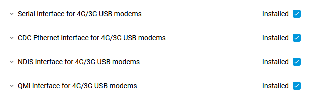

  2. Make sure that 4 components are installed in the router for compatible USB modems:
    • Serial interface for 4G/3G USB modems — Enables 4G/3G network connection via a USB modem with a serial interface; RAS (UsbModem) mode support;
    • CDC Ethernet interface for 4G/3G USB modems — Enables 4G/3G network connection via a USB modem of the CDC Ethernet type; supports CdcEthernet mode;
    • NDIS interface for 4G/3G USB modems — Enables 4G/3G network connection via an external - or internal (on select Keenetic models) - USB modem with an NDIS interface; support NDIS mode (UsbLte);
    • QMI interface for 4G/3G USB modems — Enables 4G/3G network connection via an external - or internal (on select Keenetic models) - USB modem that supports the QMI protocol; QMI mode support (UsbQmi).
    You can do this in the web configurator on the General System Settings page under Updates and Component Options by clicking on Component options. Install the specified components (from the USB modems and expansion modules section) or make sure they are already installed.
    For more information on installing router system components, see the article KeeneticOS components installation/removal.
