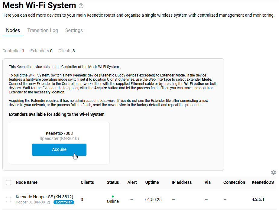

  5. Open a web browser, go to my.keenetic.net, log in to the Main Router's web interface. Open the Mesh Wi-Fi System page and click Acquire to add the Extender to your Wi-Fi System.

  5. Open a web browser, go to my.keenetic.net, log in to the Main Router's web interface. Select the Wi-Fi System section and click Acquire to add the Extender to your Wi-Fi System.
    Wait until the process is complete.
