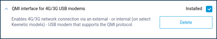

4. QMI mode (Qualcomm MSM Interface).
This interface is used for modern Qualcomm processor-based modems.
Not
Keenetic Hero 4G (KN-2310) and Keenetic Runner 4G (KN-2210) routers have an integrated LTE/4G/3G modem from Qualcomm Snapdragon X5 that works in QMI mode.
To support this mode, the special component 'QMI interface for 4G/3G USB modems' must be installed which enables USB modems operating in QMI mode.
When you connect the modem to the router, the UsbQmi interface is automatically created in the settings. You can configure the modem further on the 'Mobile broadband connection' page.
