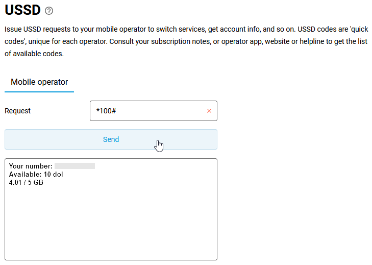

In the web interface, in the Internet menu section, click on USSD. Enter the USSD command (request code) in the Request field and press the Send button.
Codes for USSD requests vary from operator to operator. Please check the list of codes supported by your operator.

(config)> ussd UsbQmi0 send *100#
request: *100#
response: Your number: +1234567890
Available: 10 dol
4.01 / 5 GB
