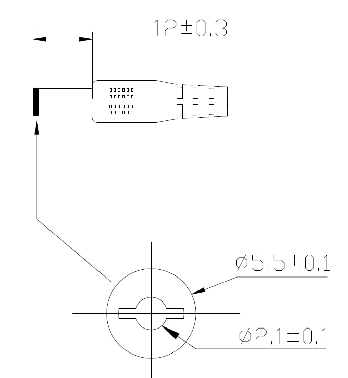

Keenetic devices use the following supplied DC power adapters with the following power jack geometry:
Router Model
Power Adapter
Keenetic Explorer (KN-1613)
12 V, 1 A
All Keenetic models are powered from 100–240 V 50/60 Hz AC power.
The power adapters have a rectified stabilized output voltage of 9/12 V with a DC current not exceeding 3.0 A.
