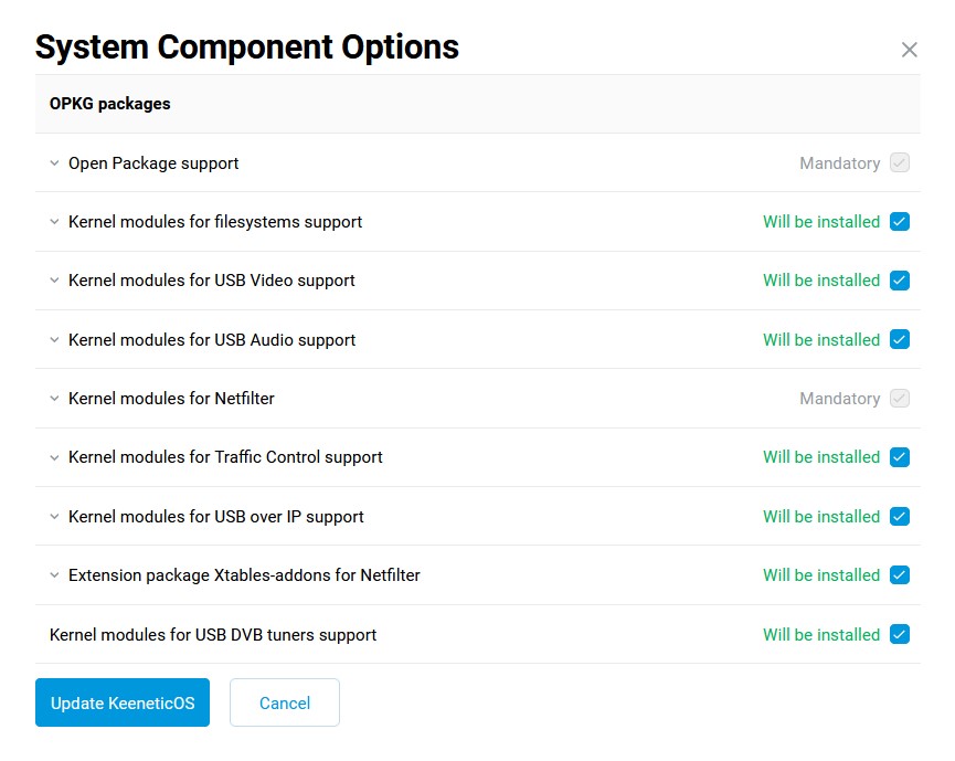

  2. In your Keenetic router, install the required OPKG components. The primary and mandatory one is the Open Package support component.

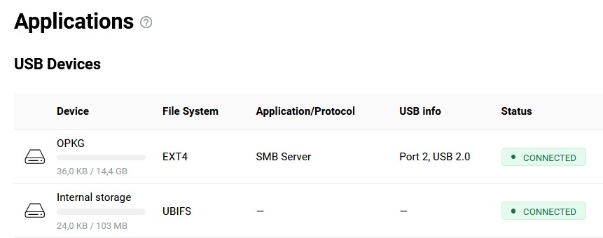

    Plug the USB drive with the ext4 file system into the router's USB port. The drive should appear on the Applications page under USB Devices.

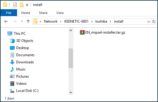

    Use a file manager to connect to the drive via the network (in Windows, you can use Explorer). In the router's settings, the SMB server application must be enabled in advance to access USB disks that you connect over the network.
    Create an install directory in the root of the disk partition where you put the file mipsel-installer.tar.gz.

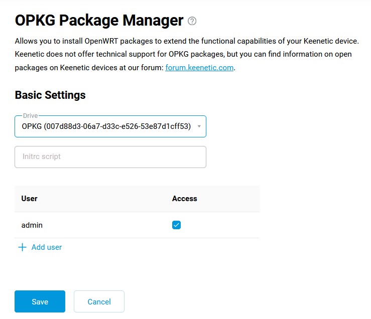

  5. Go to the OPKG Package Manager page and select the ext4 drive you have prepared in the Drive field.
    Click Save.

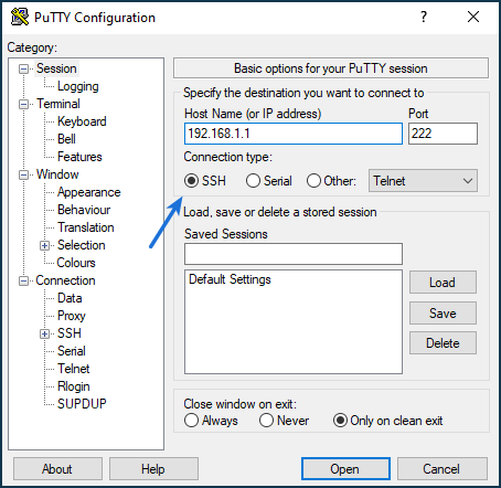

  8. Start Putty, select the SSH connection type, type the router's IP address in the Home segment (192.168.1.1 by default), specify port 222 and click Open.
    See the Terminal program for Windows article for more information on working with Putty.
    Port 222 is used if the SSH server component is installed in the router. If it is not installed, use port 22 to connect to Entware.

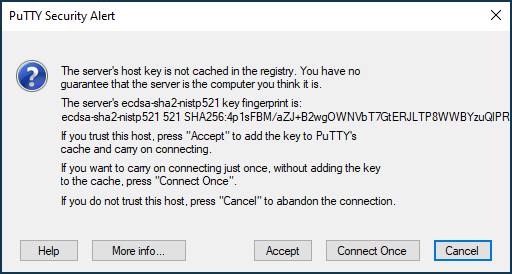

    Confirm adding the security key to the Putty cache to establish the connection.
    When booting up, confirm login by pressing Yes.

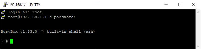

    Then go to the router settings using the Secure Shell (SSH) protocol.
    To log in, enter:
    login as: root
    root@192.168.1.1's password: keenetic

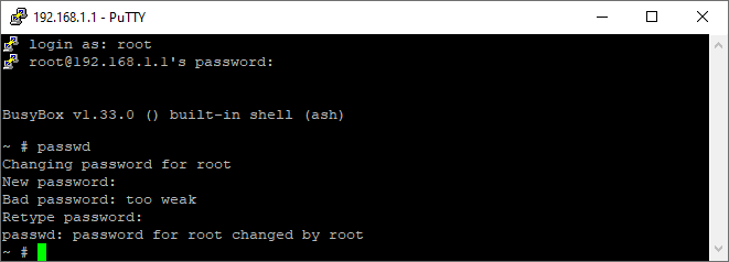

    You can set your password. To do this, enter the passwd command:
    New password: enter your password
    Retype password: confirm the password
    ~ # passwd
    Changing password for root
    New password:
    Bad password: too weak
    Retype password:

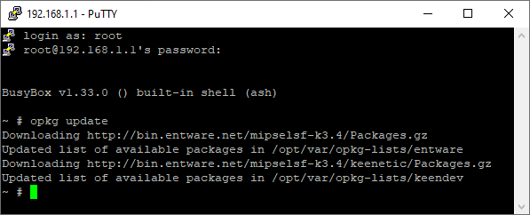

  9. After successful authorization, you will come to the BusyBox () built-in shell (ash). Now you need to update the opkg package by entering the command opkg update:
    / # opkg update
    Now you can install the necessary OpenWRT package.
