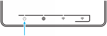

Connect the router to a power supply via the included power adapter. When the router is loaded, its Status LED (left-most), which shows the device's status, should be illuminated continuously (the router is powered on and ready to use).
