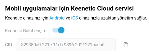

    • Make sure that Keenetic Cloud access is enabled.
      This setting can be found in the Keenetic Cloud Service for Mobile Applications menu on the General System Settings page.
