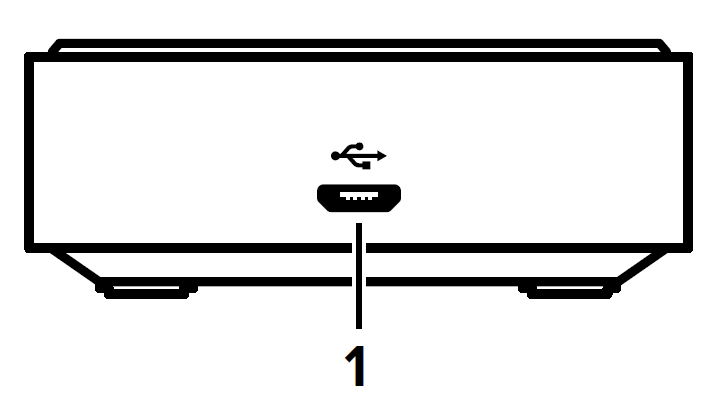

1. USB Port J
Use the supplied USB cable to connect to a compatible Keenetic device with a USB port.

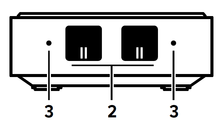

2. Phone Ports K L
Connect to an analog phone, using an RJ-11 phone cable.
3. Phone LEDs
  • Solid green — Port is ready for calls.
  • Blinking slowly — A call is in progress.
  • Off — Port is not ready or disabled.
