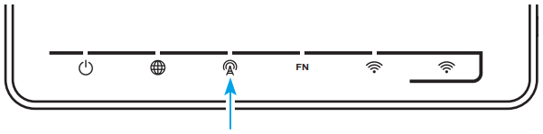

Mobile Network LED indicator statuses
Keenetic Hopper 4G+ (KN-2312) router has the Mobile Network LTE-LED-01.png indicator on the housing.
The indicator shows the connection status and signal strength of the cellular network:
  • Solid red — Invalid or missing SIM card, or incorrect PIN code.
  • Blinking blue — Searching for and connecting to a mobile broadband network.
  • Solid blue — Weak signal strength.
  • Solid green — Good signal strength.
  • Blinking green — The traffic counter reached the data limit level on the metered mobile broadband network connection. The mobile network disconnected.
  • Off — The built-in 5G/4G/3G modem is disabled.
The signal strength is indicated by an RSSI value.
RSSI (Received Signal Strength Indicator) is an indicator of the strength of the signal received by the modem. The value is measured in dBm. The minimum value acceptable for network operation is -85 dBm.
The higher the RSSI number, or the less negative it is, the stronger the signal strength (e.g. a value of -45 is greater than -80). The RSSI indicates the power level of the signal received by the modem, not the power level of the base station signal.
The green light is on when RSSI >= -75 dBm, and the blue light is on when RSSI < -75 dBm.
