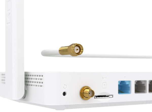

  • In Keenetic routers, the internal path from the built-in modem to the SMA connector has a wave resistance of 50 ohms. It is recommended to connect an external antenna and cable assembly with the same impedance.
Keenetic Hopper 4G+ (KN-2312) router uses an SMA female connector, and therefore, the connected external antenna must be equipped with an SMA male connector.
For more information on SMA connectors, see Types of connectors for attaching external 5G/4G/3G antennas.

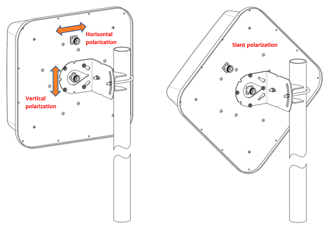

Some outdoor SISO and MIMO (in other words, two SISO antennas in one housing) antennas have markings on the cable connectors indicating the polarization direction.
Historically, operators install base stations in urban areas with MIMO antennas of cross polarization (slant polarization at an angle of +45/-45 degrees), while stations with vertical polarization can be used in non-urban areas.
Vertical polarization has shown better efficiency of radio signal propagation when bypassing obstacles than horizontal polarization.
In case the antenna on a base station is vertically polarised, then setting the MIMO subscriber antenna to a linear (vertical and horizontal) polarization position may give a better signal. In this situation, you should connect the connector on the MIMO antenna with vertical polarization to the Keenetic router in the Tx/Rx connector (it is also called the SISO antenna connector) and with horizontal polarization in the Rx connector.
As a rule, the design of outdoor MIMO antennas allows installation with both linear (picture on the left) and cross polarization (picture on the right):
Usually a manufacturer marks the connectors (inputs) on the outdoor MIMO antenna with the direction of polarization.
