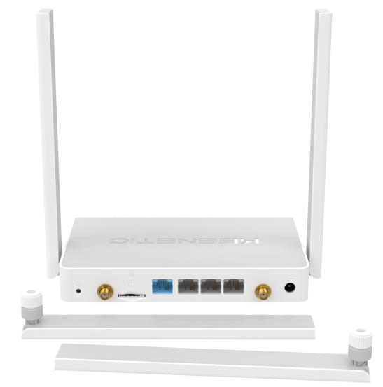

Characteristics of supplied removable LTE antennas
Keenetic Hopper 4G+ (KN-2312) comes with two removable omnidirectional cellular antennas.
SMA female connectors are used on the housing; the antennas are equipped with an SMA male connector.
The physical dimensions of the complete antennas are shown in the figure (in mm):
Characteristics of the LTE antennas supplied with the package:
