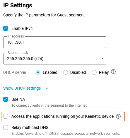

  2. In Keenetic routers, there is an access level protected. This level of access is analogous to the private level but without access to the router.
    The protected type is set for the Guest network Wi-Fi interface when the Access the applications running on your Keenetic device option is disabled in the web interface on the Guest segment page in the IP Settings section. By default, access to Keenetic is prohibited from the guest network. If you allow access to settings, this interface will be set to the private level.
