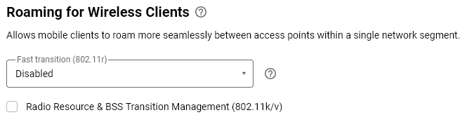

Faced with this situation, we recommend that you first update your mobile device system to the latest version available, or on your laptop, update the Wi-Fi adapter driver by going to the chipset manufacturer's website. If this does not help, the update is not available, etc., disable Fast transition (802.11r) and Radio Resource & BSS Transition Management (802.11k/v) in the Keenetic settings and then reconnect the device to the router's Wi-Fi network.
If your home network is built on a single Keenetic router (supporting only the 2.4 GHz band), turning off seamless Wi-Fi roaming will not affect your wireless network. For stationary devices that are less advanced or only work in one band, the Wi-Fi roaming setting is not relevant.

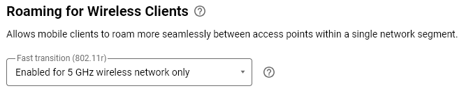

On dual-band models, you can enable roaming on the 5 GHz band only. For example, this will avoid the problem of connecting one of the devices on the 2.4 GHz band.
Roaming only for the 5 GHz wireless network will not only avoid the problem of connecting one of the old devices, but it will also switch the device between an extender and the main router only in the 5 GHz band, and this is just relevant for relatively modern and mobile clients, i.e., where it is essential (Wi-Fi calls, etc.).
