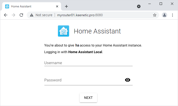

Let's look at an example of configuring remote access to the interface of a popular open-source Home Assistant intelligent home application (running on port 8123
) on a home network.

). In the case of fourth-level domains, this problem is solved because each host has its own domain name.You can then check access to the specified hosts. Although a private IP address is obtained from the ISP, access will be granted according to the defined rules.
In our example, the interface of the Home Assistant will be available at http://myrouter01.keenetic.pro:8080
