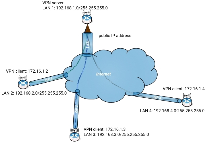

Let's take the example of connecting 4 remote LANs through a PPTP VPN server. Each network has access to the Internet. The settings will be identical for the L2TP/IPsec VPN server and SSTP VPN because the logic used in Keenetic is the same for these servers.
The Keenetic router on which the PPTP VPN server will run must be connected to the Internet with a public IP address. When using a KeenDNS domain name, it must be configured in Direct access mode, which also requires a public IP address. If these conditions are not met, connecting to such a server from the Internet will not be possible.
Let LAN 1 be connected to the Internet via a public IP address located behind a router with a PPTP server. Each LAN 2-4 will connect to the VPN server using a PPTP connection. The main task is to provide access between all the LAN 1-4 networks to be joined together.

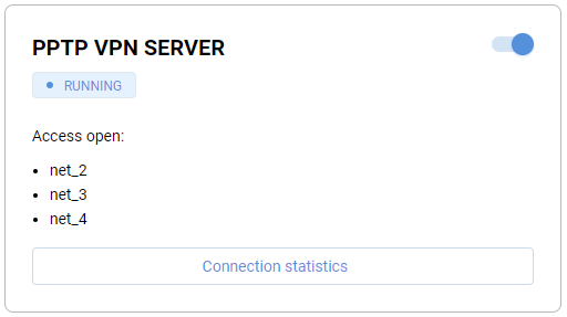

In this example, the 'master router' (with the PPTP VPN server) will be the VPN Concentrator. All PPTP connections will be established with it, and routing between all connected subnets will be performed. In the settings of the master router, create as many user accounts with VPN server access rights as you plan to connect to it (in our example, three accounts – net_2, net_3 and net_4 – are created for three remote subnets).

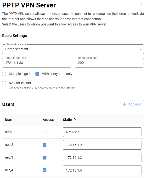

Let the VPN server provide each client with the following IP addresses: 172.16.1.2, 172.16.1.3 and 172.16.1.4, respectively (please note that these IP addresses belong to the same subnet). To configure the VPN server, go to the Applications page.

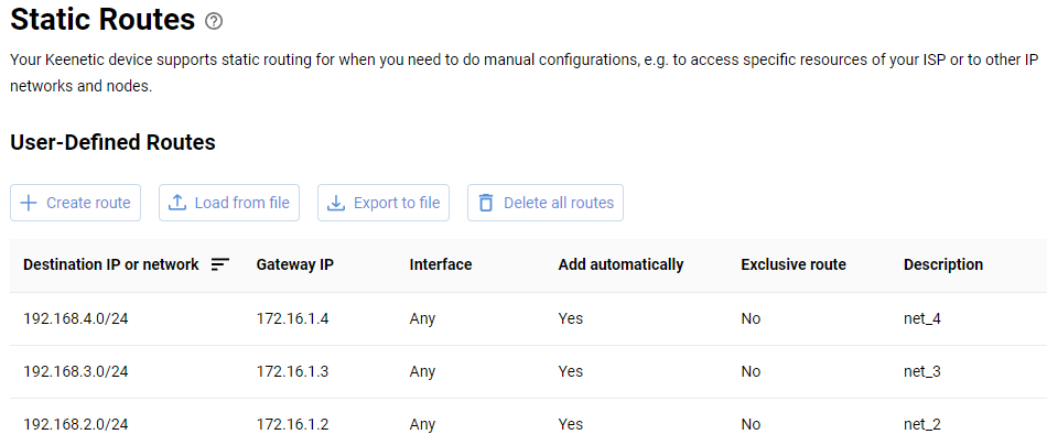

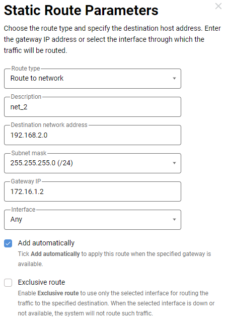

Static routes on the master router (with the VPN server) will include the following entries: For each network to be joined, except the 'Home network' of the server itself, you must specify the IP address allocated to the corresponding user by the VPN server as the gateway address. Configure static routes on the Routing page.

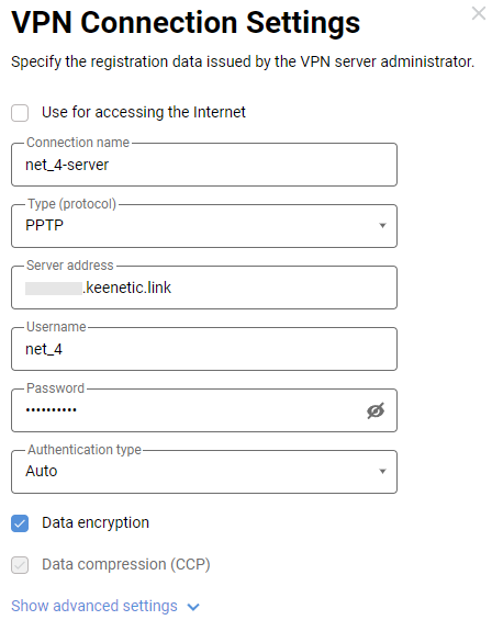

In the Server address field, enter the public static WAN IP address of the master router or its KeenDNS domain name (in this case, the Direct access mode must be used in the KeenDNS server settings, which also requires a public IP address).

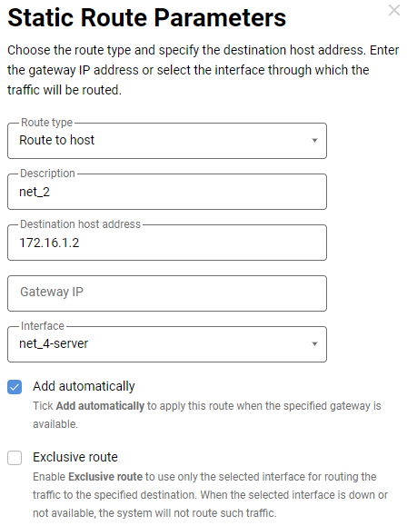

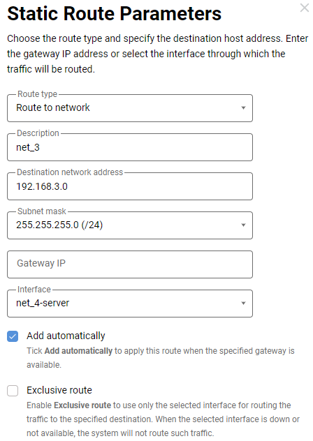

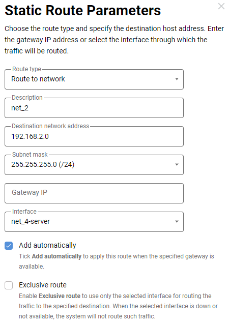

Two routes indicate the location of the LAN 3 network:
To communicate with the LAN 4 subnet, you will need to specify the following routes:

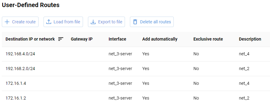

Setting up a VPN client from LAN 3 (192.168.3.0/24):

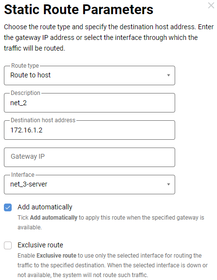

The following routes will provide communication with the LAN 2 network:

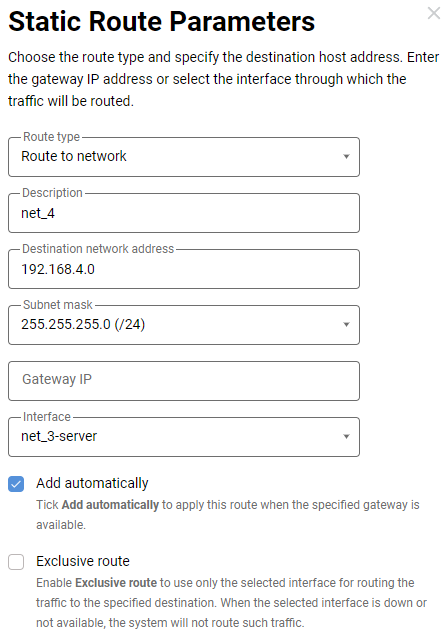

To communicate with the LAN 4 network, specify the following routes:
Setting up a VPN client from LAN 4 (192.168.4.0/24):

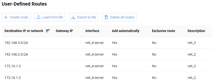

The following routes must be added to communicate with the LAN 2 network:
The following routes must be added to communicate with the LAN 3 network:
1. It is recommended not to enable the Use for accessing the Internet option when setting up connections to the VPN server in this scheme, as it eliminates the need to specify routing settings to the network behind the server manually. If you don't check this box, routes to the network behind the server will automatically be sent to the Keenetic client device.

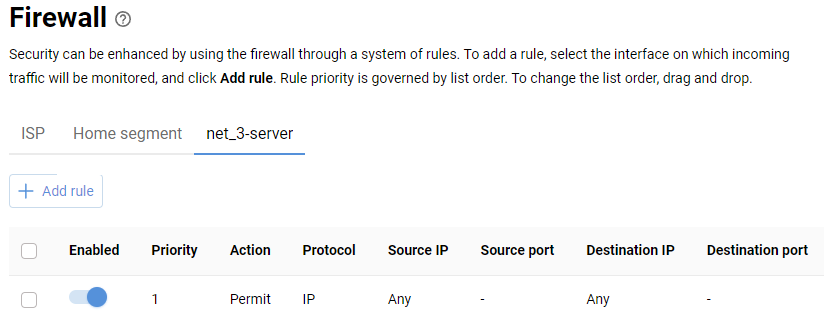

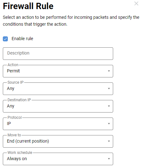

3. Since a firewall is enabled on the PPTP client interface by default, blocking all incoming connections, you will need to open the ports/protocols you need in the client router settings. On the Firewall page, you need to create the appropriate allow rules for incoming connections via any protocol (it will be enough to open access via the IP protocol). For example, a rule for a LAN 3 router would look like this:
