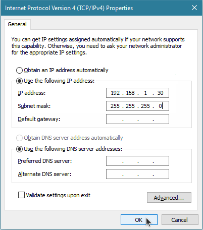

  3. On the computer in your operating system, open the network settings (Control Panel > Network and Internet > Network connections > Connection properties > select IP version 4 (TCP/IPv4) and click Properties).
    Manually set to use any IP address in the 192.168.1.4 ~ 192.168.1.254 range with a mask of 255.255.255.0 (in our example, we have set the IP address to 192.168.1.30).
    Then enter the IP address 192.168.1.3 in your Internet browser to access the Extender's web interface.

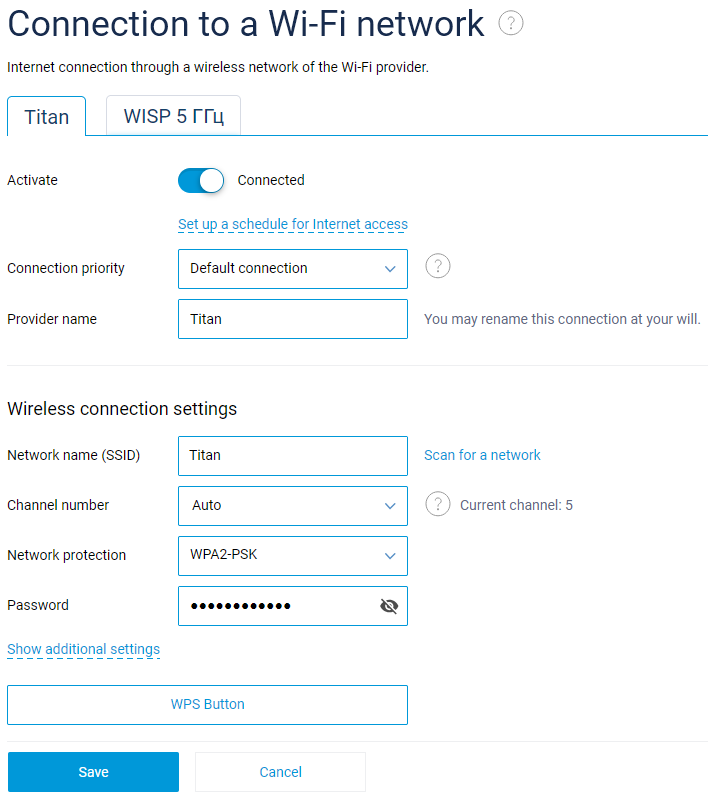

  5. In the web interface, go to the Wireless ISP menu, and on the Connection to a Wi-Fi network page, click Scan for a network and select the desired network. Then enter the password for the main router's network connection in the Password field. Save the settings.

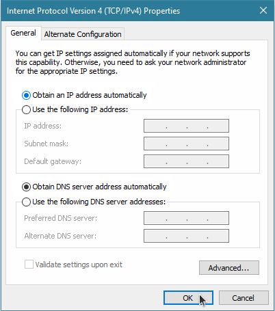

  7. Open the network settings again on the computer ((Control Panel > Network and Internet > Network connections > Connection properties > select IP version 4 (TCP/IPv4) and click Properties). In the protocol properties window, return the Obtain IP address automatically to assign a dynamic IP address and DNS server to the computer's network adapter.
