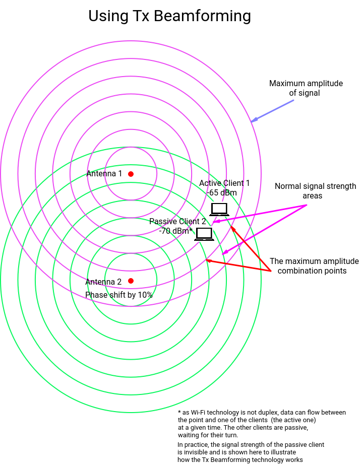

  • The Wi-Fi receiver (wireless client) is located at some distance from the access point. The access point determines the position of the receiver in space based on its radio signal. In our example, there are 2 wireless clients connected to the access point. Wi-Fi technology uses Time Division Multiplexing (TDM), i.e. data exchange at a given moment can go between the AP and one of the active clients, while the other clients are passive — waiting their turn.

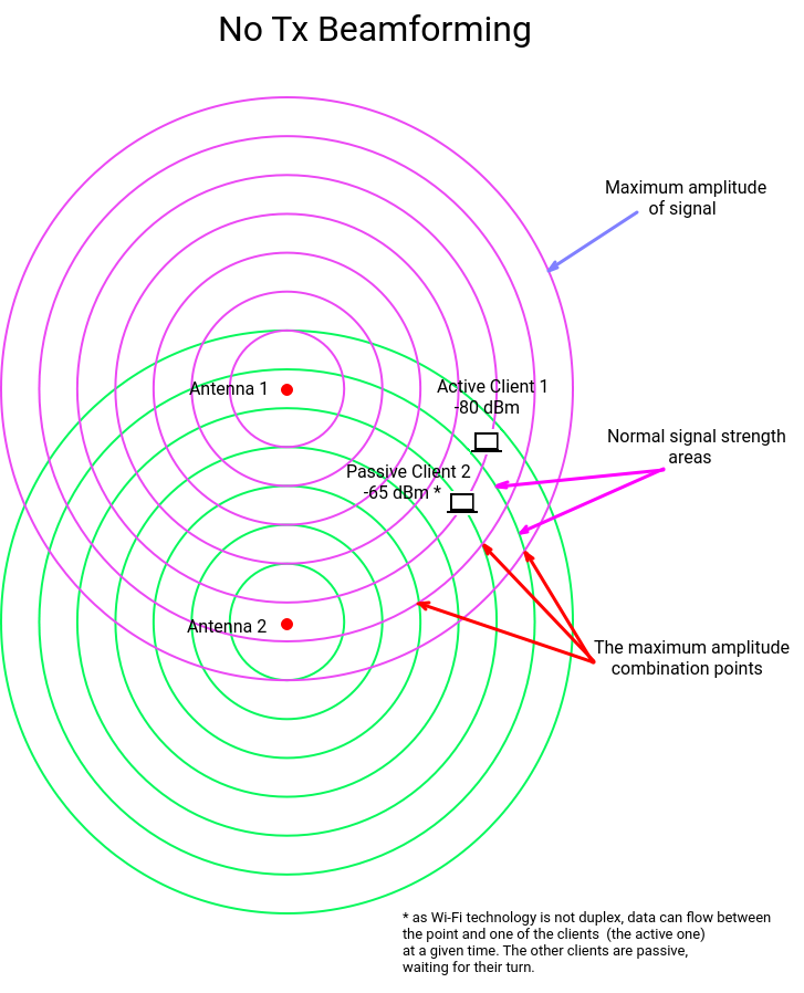

  1. Without Beamforming, both Wi-Fi access point antennas broadcast identically. The amplitudes of the signals add up at each point in space — consequently, there are points where the amplitudes add up to give the maximum signal level, and points where the amplitudes are opposite — the signal here will be minimal. In this example, Client 1 is located in a relatively 'unlucky' remote area with low signal strength. Client 2 is more fortunate — the amplitudes of both antennas are at their maximum. The signal level remains more or less constant regardless of which client is active at the moment.
  2. With Beamforming, one of the antennas sets the 'base' waveforms, and the other 'adjusts' the signal by phase shifting so that the signal amplitudes of both antennas are maximised at the client's location. In our example, Client 1 is initially active, and the phase shift occurs so that the maximum wave amplitudes of both antennas are reached at its location point. The signal at Client 2 (as well as in other areas), on the contrary, decreases at this point, which reduces the overall noise level and also leads to an increase in signal strength at Client 1.

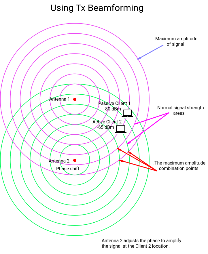

    When Client 2 becomes active, Antenna 2 shifts the phase again in favour of Client 2. Antenna 2 adapts the phase to amplify the signal at the client location.
