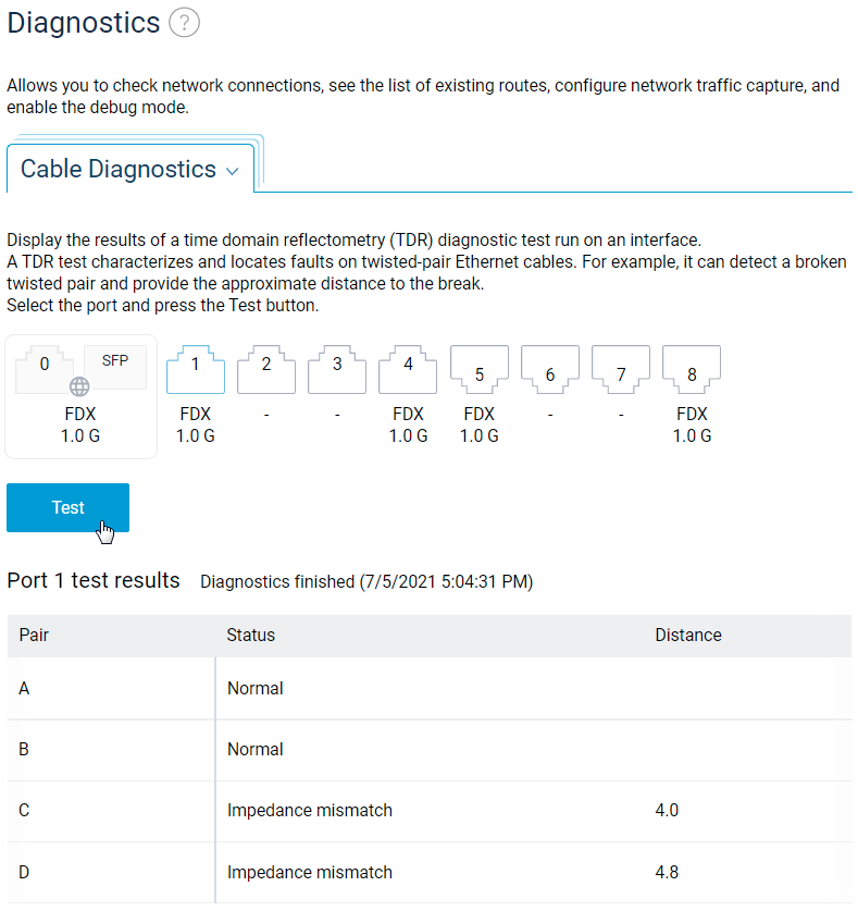

In the router's web interface, go to the Diagnostics menu, select a port on the Cable Diagnostics tab, and click the Test button. The Pulse Reflectometry Diagnostic Test (TDR) results on the selected interface will be displayed below.

  • Normal — The pair is connected, and no problems are detected;
  • Not Connected — No contact with the terminal device. This may indicate an unconnected cable; a faulty or low speed port on the terminal device; or a break in the pair's conductors;
  • Shorted — The twisted-pair wires are short-circuited;
  • Impedance mismatch — Possible causes of impedance mismatch are: twisted pair not properly crimped (reversed conductors); damaged pair conductors; defective connector at end of cable;
  • No signal — The other end of the pair is connected to the port with the power off. This usually means that there is no problem with the pair itself;
  • Distance — The distance to the fault in metres. If no problems are found in the pair, this value is 0.
