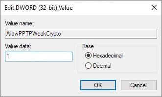

Option 2. In Windows 7/8/10, you can enable the 40-bit key support for the MPPE protocol. This can be done using the Registry Editor (regedit).
Registry Editor is a tool for advanced users only. It is designed to view and modify settings in the Windows Registry that contain information about your computer's operation.
Modifying the registry incorrectly can cause serious problems, so follow the steps below carefully. For added protection, it is advisable to back up the registry before editing it, which will allow you to restore the Windows Registry if problems occur.
To run the Registry Editor in Windows 7/8/10, press Win + R, type regedit and click OK.
Go to HKEY_LOCAL_MACHINE\System\CurrentControlSet\Services\Rasman\Parameters, find the AllowPPTPWeakCrypto parameter, double-click on it to change the parameter and set 1 instead of 0 in the Value field (hexadecimal must be used). Then click OK and exit the Registry Editor.
After editing the registry, the operating system must be restarted for the changes to take effect.
