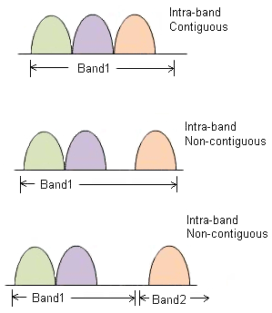

  • B1 + B1/B3/B8/B20
  • B3 + B3/B7/B8/B20
  • B7 + B7/B8/B20
  • B38 + B38
  • B40 + B40
  • B41 + B41
1*. Aggregation of two frequencies (carriers) within one band, e.g. B7 + B7, is only supported for contiguous intra-band CA.

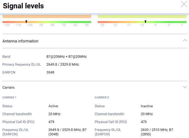

The web interface of Hero 4G+ (KN-2311) shows the connection frequencies in the aggregation under Mobile > Show signal levels.
If your smartphone supports carrier aggregation, you can use the free NetMonster Android app to check the base station's carrier aggregation availability. The app will show on which frequencies the aggregation is currently active.
