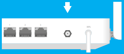

Keenetic Hero 4G+ (KN-2311) router uses an SMA female connector, and therefore, the connected external antenna must be equipped with an SMA male connector.

When connecting the SISO antenna, use the following connector on the case:
