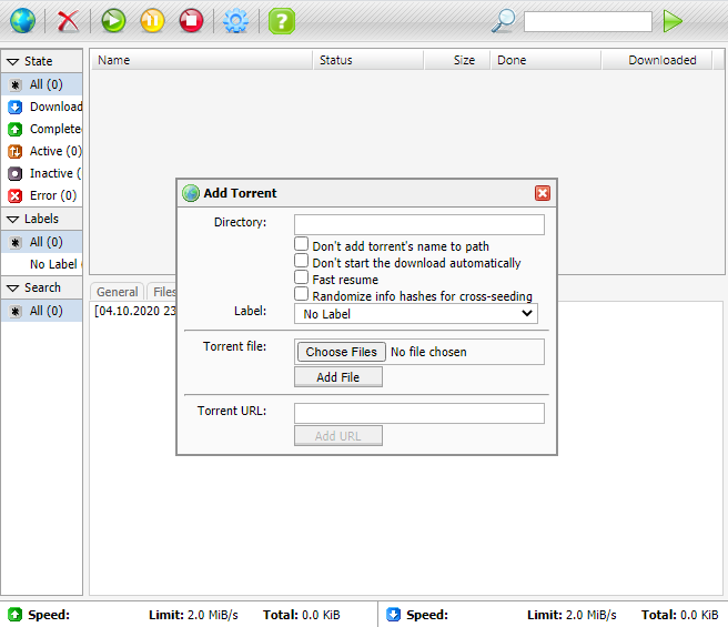

    You can set your login/password, port, upload/download speed, the path for downloading torrent files:

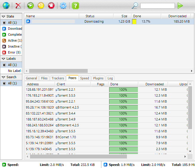

  12. Go to the rTorrent web interface at http://192.168.1.1:81/rutorrent/, configure and check how it works:
