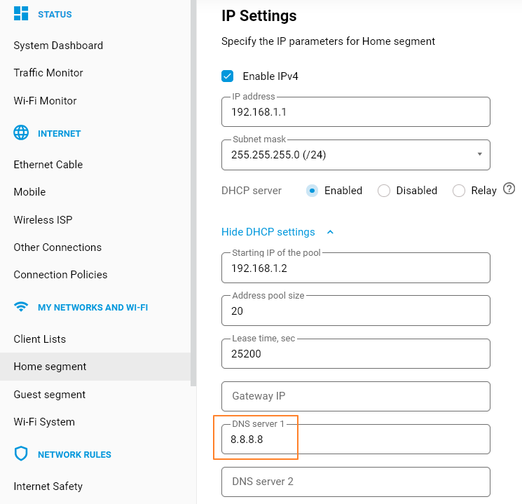

  • My Netwoks and Wi-Fi on the Home segment page (in DHCP server settings);

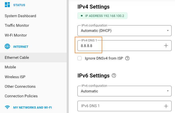

  • Internet on the Ethernet Cable / Wireless ISP / DSL connection pages (in IP settings);

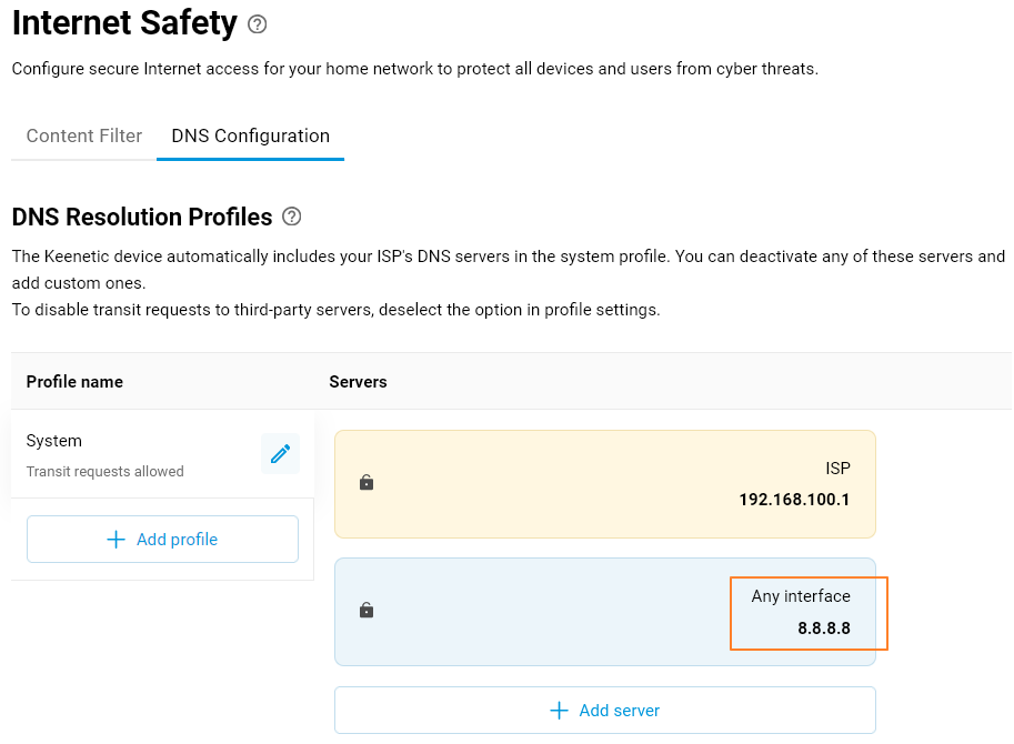

  • Network Rules on the Internet Safety page (on DNS Configuration tab).
You can add a DNS server in the advanced DHCP settings of your home network.
The DNS addresses entered here will be assigned via DHCP to devices in your home network. And in this case, the devices will directly contact these addresses, not the Keenetic DNS proxy router.
If you do not make the settings above, home devices will address the Keenetic DNS proxy server, and it will then transmit these requests to the DNS servers from its list.
The Keenetic DNS proxy server list includes DNS addresses obtained from a provider and manually entered in the Internet menu of the Internet connection page (Ethernet Cable / Wireless ISP / DSL connection) or on the Internet Safety page.
The only difference between the last two settings is that in the first case, the DNS server address in the in the Internet menu will be bound to the current Internet connection, and in the second case (in the Network Rules menu on the Internet Safety page), it is possible to bind it to any connection of the router. Binding is needed when you have a connection to multiple providers, and you need to configure different DNS for each of them. For more information on how to manually add your own DNS servers, see the Additional DNS servers article.

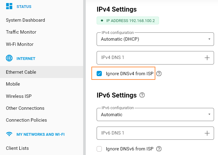

To allow only user-defined servers in the DNS list and not use provider servers, you must enable the Ignore DNS option for internet connections.
If the provider uses login and password authentication, the same option should be enabled in the associated PPPoE, PPTP, or L2TP connection settings.
For more information, see the article How to ignore your ISP's DNS.
