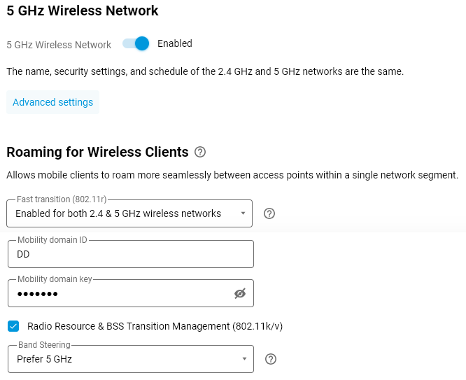

  1. If you use the same network names for 2.4 and 5 GHz, turn on seamless roaming in the router web interface in My Networks and Wi-Fi settings, specifying Mobility domain ID and Mobility domain key (enter any values; these parameters will only work between 2.4 and 5 GHz). Also, enable Radio Resource & BSS Transition Management and set Prefer 5 GHz in the Band Steering field.
    This configuration scenario is preferred by those clients who can work with 802.11r/k/v standards (most new devices).
    Be sure to configure seamless roaming settings even if Keenetic is the only router on your home network. The point is that roaming is also performed between the adjacent range access points within the same router.
    With KeeneticOS versions below 3.4.3 for better compatibility, you should use the WPA2 network protection protocol when roaming is enabled; otherwise, in WPA2+WPA3 mode, devices may prefer WPA3 and lose seamless transitions. FT is supported in WPA3 mode with version 3.4.3 and above.

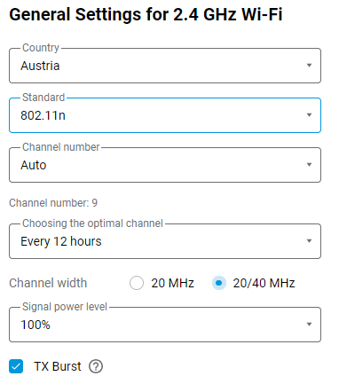

  2. Choose the 802.11gn or 802.11n standard in the 2.4 GHz Wi-Fi (the main idea is to remove 802.11b and prohibit devices from connecting by to this standard), select to search for the optimal channel every 12 or 24 hours, or manually set the channel number, set the signal strength to 100%.
    How to select the channel to operate the wireless network is shown in the instruction How do I scan a Wi-Fi network and determine the freest channel?

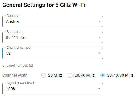

    In the 5 GHz Wi-Fi network settings, manually set the channel number from 36 to 64. Some devices may not work with channels in the upper band (above 140). For more information, see the article Your mobile device can't see the 5 GHz Wi-Fi network?
    There is a nuance on Keenetic devices that support 160 MHz channel width. If you don't have devices that support this width, it's better to exclude 160 MHz and use the 20/40/80 option instead. If you need to use a 160 MHz width, you should manually set channel 36, as this width implies that the client occupies the entire 36-64 channel block.
