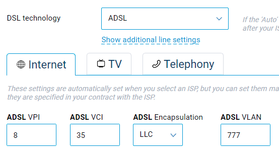

The VLAN 802.1Q setting over permanent virtual circuit (PVC) is now available for ADSL connections. [NDW-1414]
