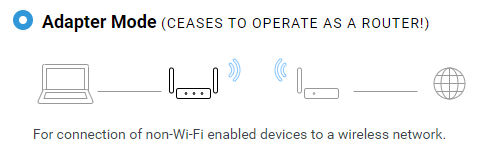

In Adapter mode, Keenetic operates as a wireless bridge with its own access point disabled, providing access to the Wi-Fi network to all devices connected to its network ports. This way, you can avoid routing an Ethernet cable to your IPTV, computer, or other devices without a Wi-Fi adapter. You can only connect to the main Keenetic via Wi-Fi. A Keenetic router in Adapter Mode can only be connected to your main Keenetic via an Ethernet network cable. Home devices can be connected to your Adapter via both Wi-Fi and an Ethernet cable.

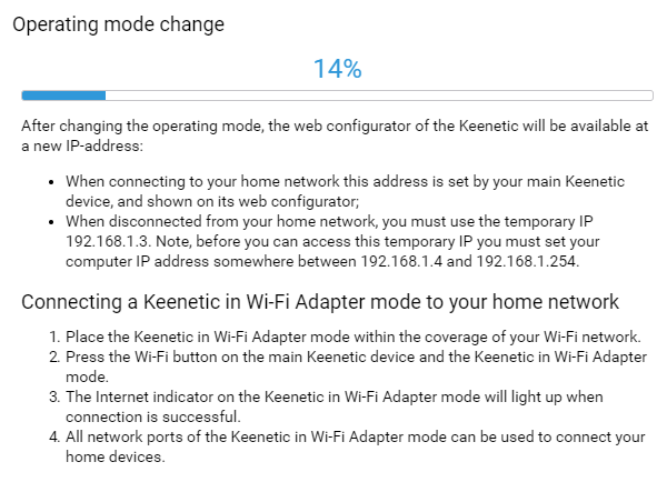

It is assumed that the device receives an IP address via DHCP from the main router by default. If no IP address has been obtained, the device is assigned a service static IP address of 192.168.1.3. When a DHCP server appears on the network, the service IP address is automatically disabled. You can only connect to the web interface using the new IP address that will be obtained from the main router via DHCP.

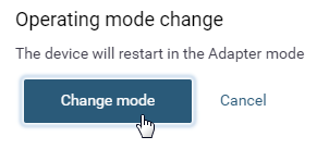

You will see a warning window about changing the device's operating mode. Press Change mode to confirm.
Next, you will see the mode change status and an information message about connecting your Keenetic in the selected mode to your home network and how to access its web interface after changing the operating mode.
