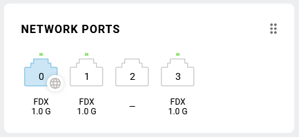

— Before testing, determine the local IP address of the device that will act as the server (this can be done in the web interface on the Client lists) page.
— Before testing, check the physical channel speed of the devices in the router settings (for Wi-Fi clients on the Client Lists page and for wired clients on the System Dashboard page). The link must correspond to the maximum possible channel speeds. For example, if a device is connected via a network cable to a gigabit router, you need to use a 4-pair cable (8 wires) of category 5e or higher, and the link should be 1G/FDX (1 Gbit/s, full duplex). In lower-end models, it should be 100M/FDX (100 Mbit/s, full duplex). If the channel speed is lower or you see HDX mode (half-duplex), check the patch cord (Ethernet cable, twisted pair) for compliance with the standard, replace it, and also look into the network adapter settings (to see if the speed limit mode is set manually).

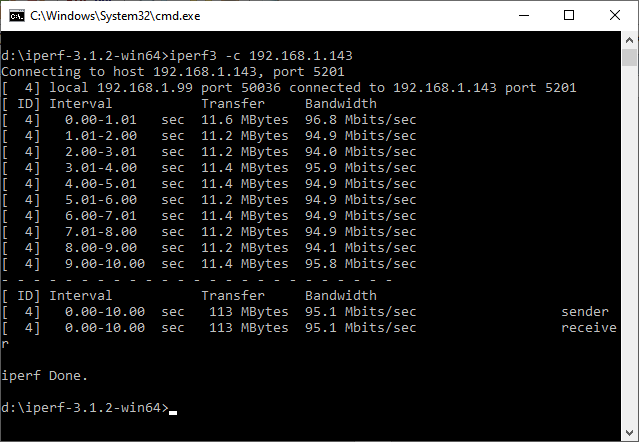

Example 1. Let's say you need to find out the bandwidth of a local network between two computers connected to a Keenetic gigabit router via a 4-pair patch cord. In our case, the computers are connected to ports numbered 1 and 3.

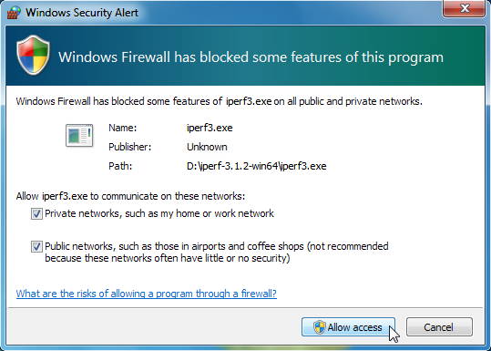

If the Windows Firewall is enabled on your computer, the Windows Security Alert window will appear when you first launch the application. Click the Allow access button to open the port on which the iperf3 application will run.

On the computer acting as the client, run the following command to start testing:
iperf3 -c <server_address_iperf3>
For example:
iperf3 -c 192.168.1.143
For 10 seconds, traffic will be exchanged between these hosts, after which the connection will be terminated and the test results will be displayed. In our example, the bandwidth measurement for the local gigabit connection was 949 Mbit/s. In this case, this value is the actual connection speed on the 1 Gbit/s link.
Caution
By default, the iperf3 program transfers traffic from the client to the server, uses the TCP protocol, and performs testing for 10 seconds without limiting the maximum speed.
When measuring the bandwidth of the local network through a router with 100 Mbit/s ports, the actual speed was 95.1 Mbit/s.

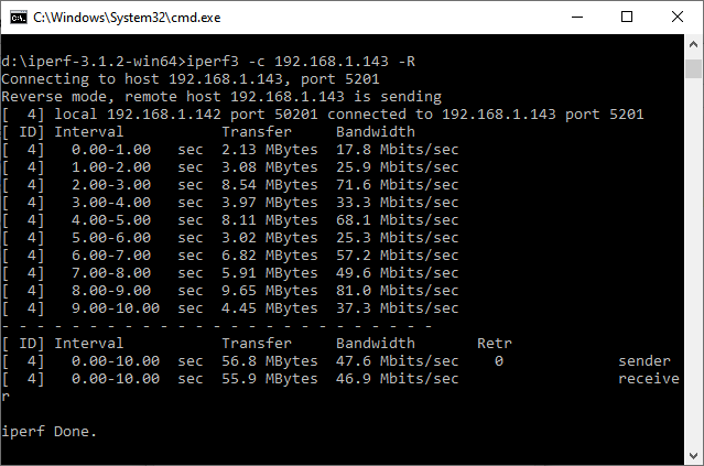

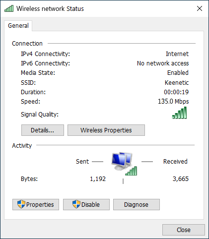

Example 2. Let's take a look at measuring the actual connection speed of a laptop connected to a Keenetic router via Wi-Fi. In our example, the laptop is connected to the router at a channel speed of 135 Mbit/s.
On the computer that is connected to the router via cable and will act as the server (in our example with IP address 192.168.1.143), run the following command in the operating system command line:
iperf3 -s
On the laptop acting as the client, run the following command to begin testing:
iperf3 -c <server_address_iperf3> -R
You will then see the result of this command. In our example, the bandwidth measurement for the local Wi-Fi connection was approximately 47 Mbit/s (with a channel connection speed of 135 Mbit/s). This is the actual speed of the connection.
Caution
When measuring a wireless connection, it is recommended to enable Reverse Mode to test the incoming speed on the client (in this case, the server transmits data and the client receives it). Add the -R key to the command. When testing a Wi-Fi connection, you may notice that the speed values obtained differ significantly, which is normal and is due to the nature of data transmission in Wi-Fi networks.

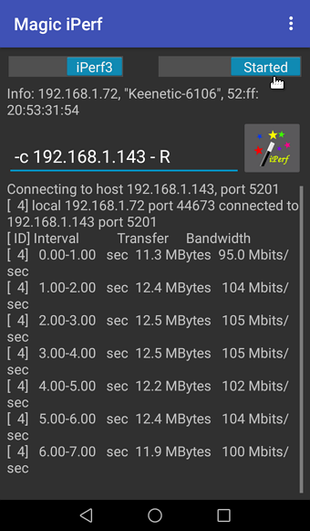

On the Android smartphone acting as the client, install the Magic iPerf including iPerf3 app. Launch it and in the upper left corner of the screen, switch the toggle to the iPerf3 position.
Use a command like this:

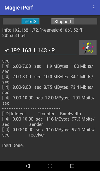

Start testing by moving the switch to the Started position in the upper right corner of the screen.
You will see the result of executing this command. In our example, the measured bandwidth of the local Wi-Fi connection was approximately 97 Mbit/s (with a channel connection speed of 200 Mbit/s). This is the actual connection speed of the Wi-Fi client.

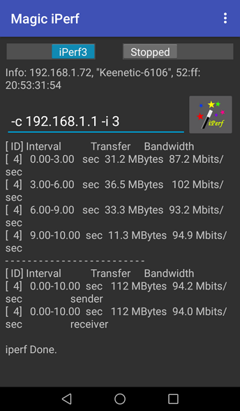

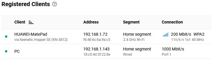

Example 4. Let's measure the actual connection speed on a smartphone/tablet connected to a Keenetic router via Wi-Fi. In our example, the smartphone is connected to the router at a channel speed of 200 Mbit/s.

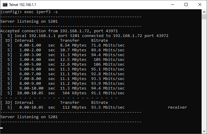

But the Keenetic router itself will act as the server (its local IP address is 192.168.1.1).
Tip

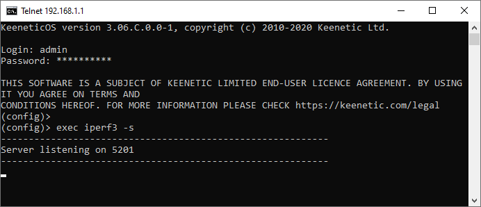

The iperf3 package is present in the KeeneticOS router operating system when the Open Package support component is installed.
Connect to the command line interface (CLI) of the router and execute the command to start the iperf3 server:
exec iperf3 -s
Use the following command:
Run the test by moving the switch to the Started position in the upper right corner of the screen.
In our example, the measured bandwidth of the local Wi-Fi connection was approximately 94 Mbit/s (with a channel connection speed of 200 Mbit/s). This is the effective connection speed.
You can also see the test results in the server terminal.
