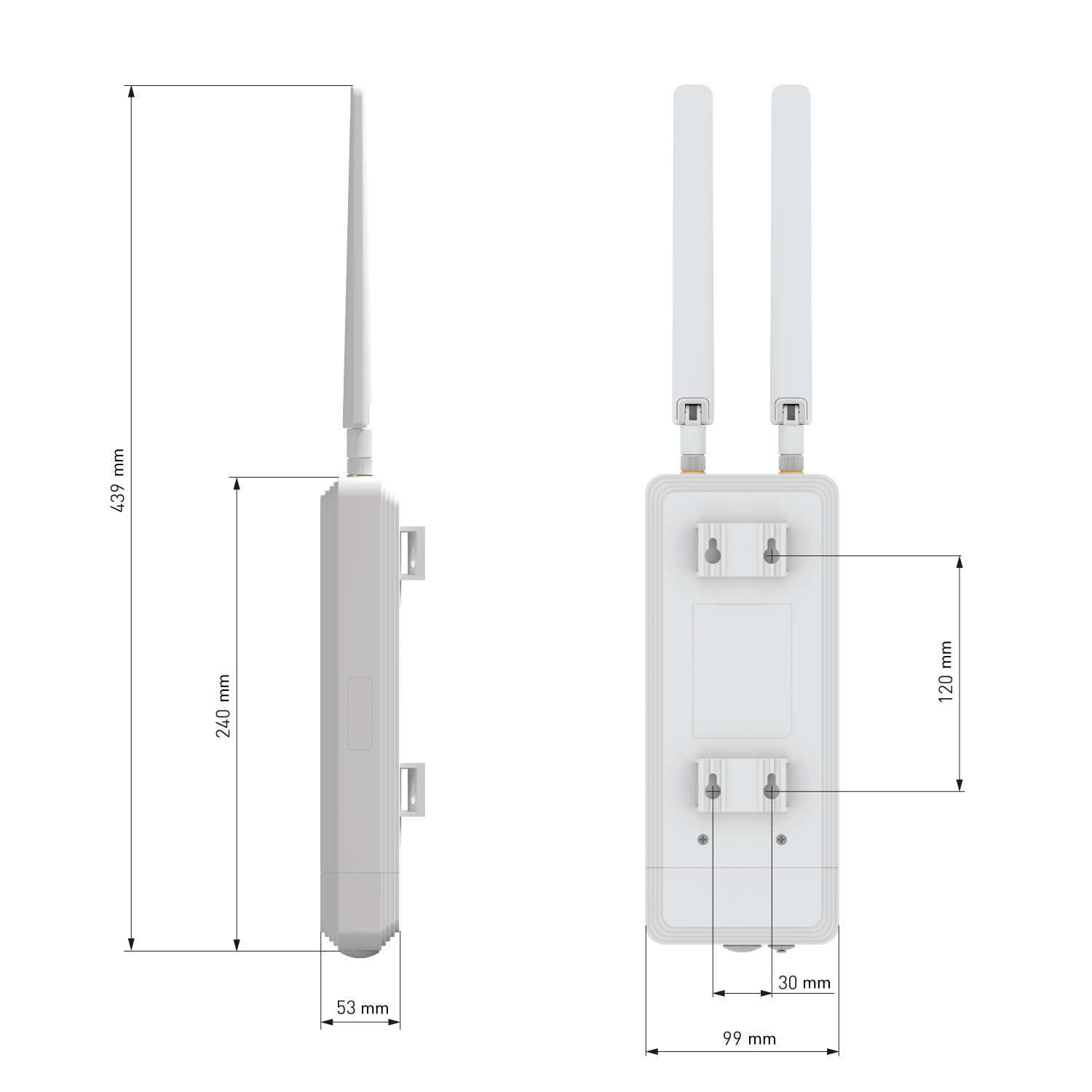

Wall-mounting template showing the distance between the mounting holes for your Keenetic model:

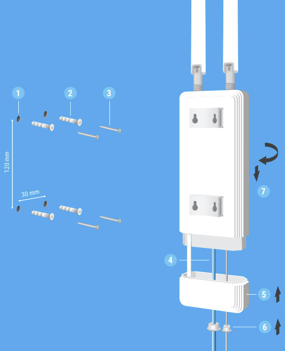

Mounting to a wall
  1. Mark the four fixing points on the wall: 30 mm apart horizontally and 120 mm apart vertically. Drill a 5 mm diameter hole at each marked position.
  2. Insert the ribbed plastic wall plugs into the holes. For drywall surfaces, screw in the drywall anchors with a screwdriver until they are flush with the surface.
  3. Drive the self-tapping screws into the wall plugs/anchors, leaving approximately 5 mm of the screw protruding from the surface.
  4. Route the Ethernet and grounding cables through the dedicated openings in the bottom cover, then connect them to the access point.
  5. Slide the bottom cover upwards onto the main body until it is fully seated and secure.
  6. Use the supplied rubber plugs to seal the openings around the Ethernet and grounding cables.
  7. Hang the access point on the screws.

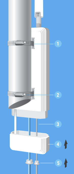

Mounting to a pole
  1. Thread the metal straps through the mounting slots on the back of the Keenetic access point.
  2. Position the access point against the pole. Wrap the straps around the pole and lock and tighten them with a screwdriver.
  3. Route the Ethernet and grounding cables through the dedicated openings in the bottom cover and connect them to the access point.
  4. Slide the bottom cover upwards onto the main body until it is fully seated and secure.
  5. Use the supplied rubber plugs to seal the openings around the Ethernet and grounding cables.
