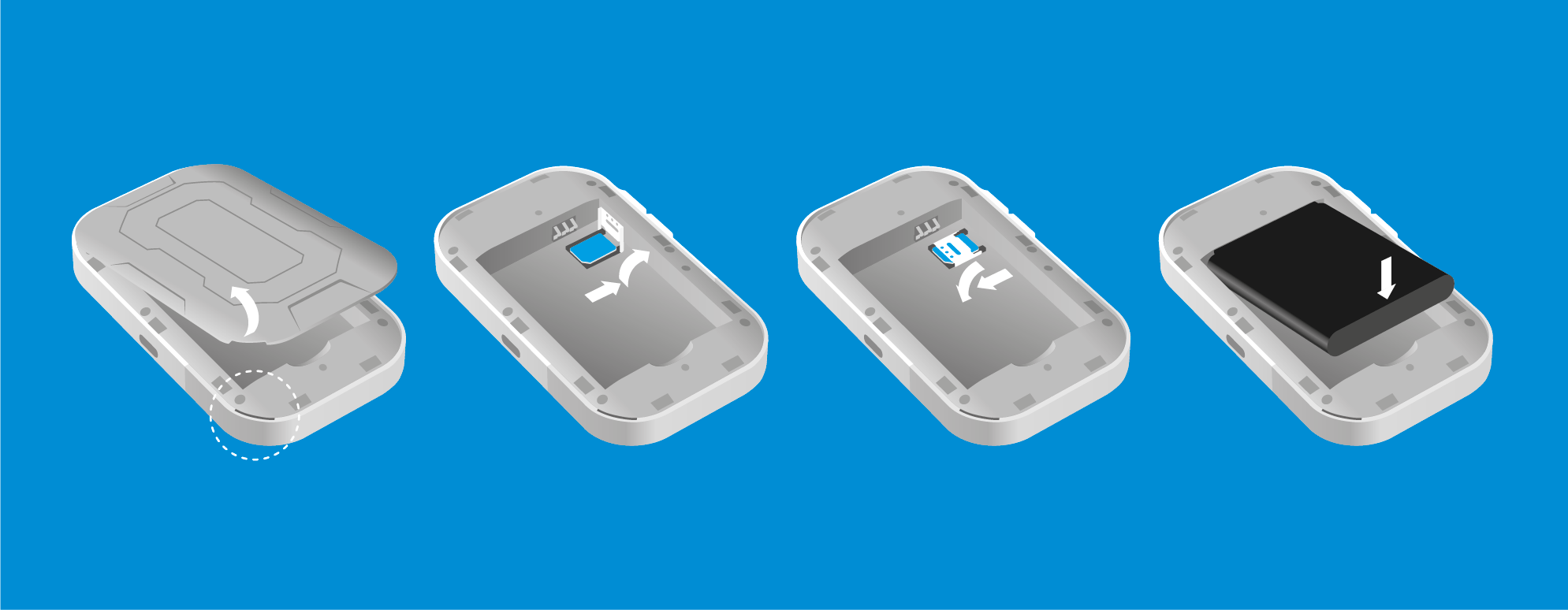

Installing the SIM Card and Battery
To use your Keenetic Roamer 4G (hereinafter ‘Mobile Hotspot’, ‘Keenetic device’), you need to install a valid, activated nano-SIM card with a data plan from your mobile operator. Use a SIM card without a PIN for quick setup.
Open the back cover. Gently slide and lift the hinged metal SIM card slot cover. Insert the SIM card into the slot as shown on the device label. Close the SIM card slot cover and slide it back to lock it in place. Install the battery and close the back cover.

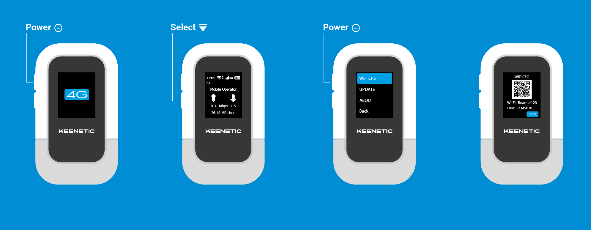

Connecting to the Internet via Wi-Fi
Press and hold the Power Button i until a welcome message is displayed. From the Mobile Hotspot home screen, press the Select Button j and then the Power Button i to display the Wi-Fi settings. Use the Wi-Fi network name (Wi-Fi) and password (Pass) displayed on the screen to connect to your Mobile Hotspot. Alternatively, you can scan the QR code to automatically connect via Wi-Fi.
If other messages appear on the home screen, please refer to the Frequently Asked Questions section below.

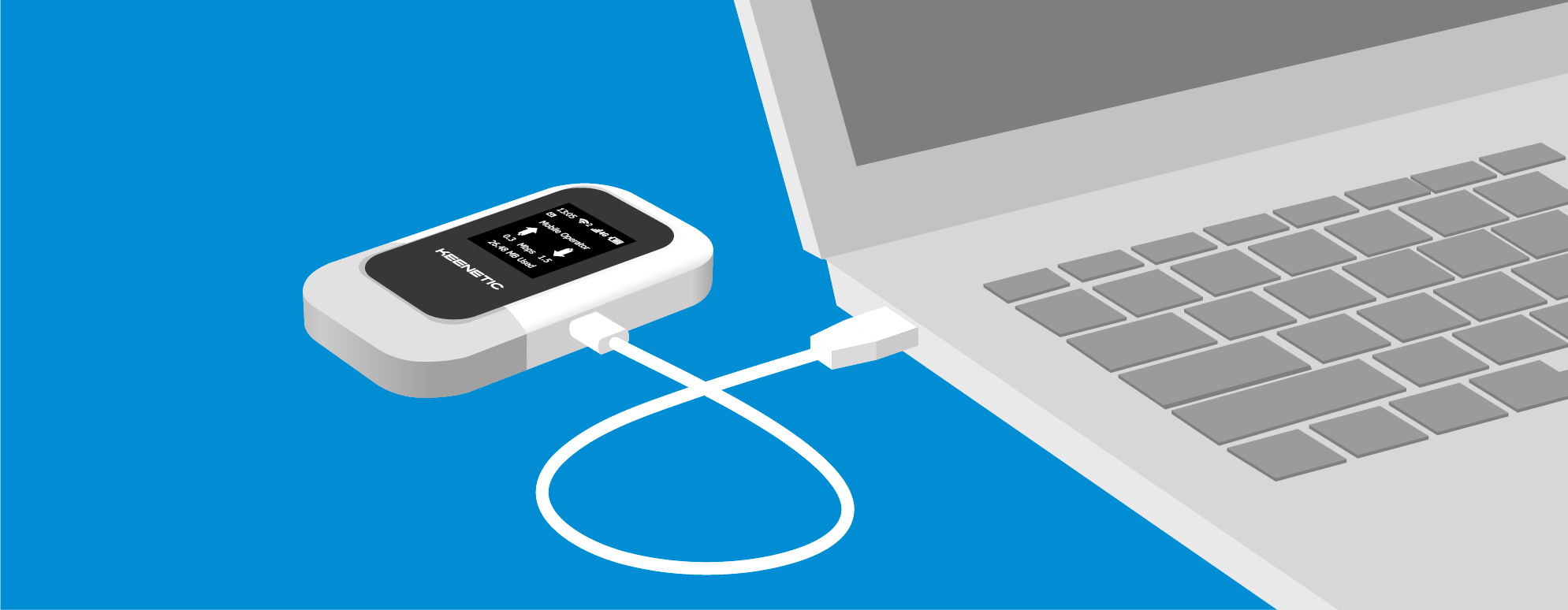

Connecting via USB
Roamer 4G supports USB tethering. This allows your computer or Keenetic router with a USB port to use the mobile network directly through a USB connection, with no drivers required.

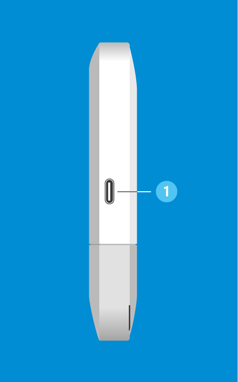

1. USB Type-C Port
To charge the battery, use either a 5 W or higher USB-C charger, a USB port on your computer, or a power bank.

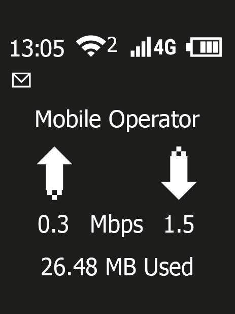

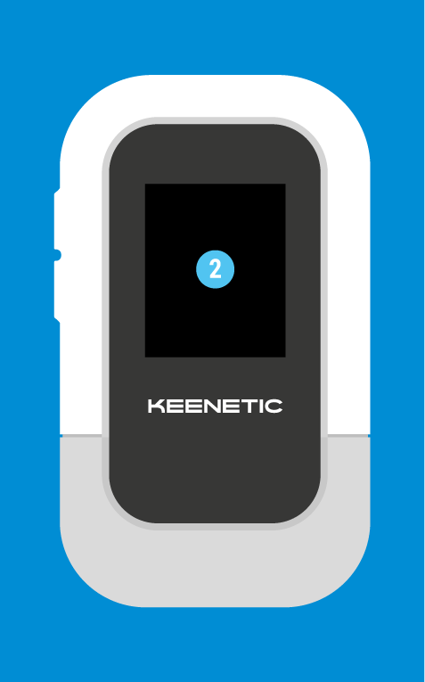

2. LCD Screen
From your mobile hotspot’s home screen, you can view your connection and Wi-Fi status, data usage details, and more.
Signal strength.
Network type.
Wi-Fi status and number of connected clients.
Battery status. When charging, the battery status has a connector icon on it. When the connector icon disappears, the Mobile Hotspot is fully charged.
Unread SMS messages.
Upload speed (Mbps).
Download speed (Mbps).

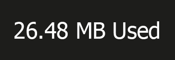

Cumulative data usage.

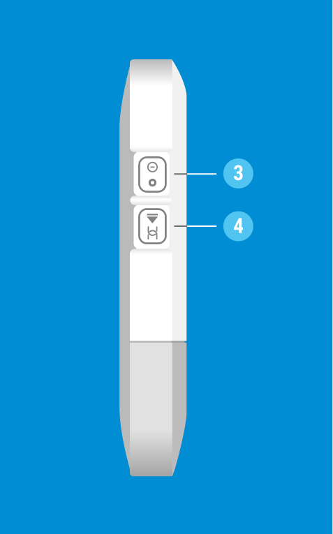

3. Power Button i
Press to turn the display on or off, or to confirm a selection.
Press and hold for 6 seconds to turn the device on or off.
4. Select Button j
Press to switch between screens.

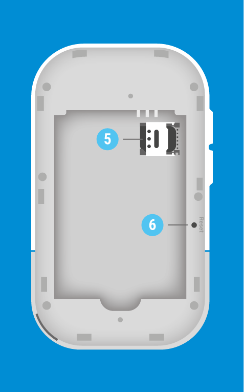

5. Nano-SIM Card Slot
Roamer 4G is SIM-unlocked for the best 4G offers. Use a SIM card without a PIN for quick setup.
6. Reset Button
Press and hold until a welcome message is displayed to restore factory settings and reset the administrator password.
