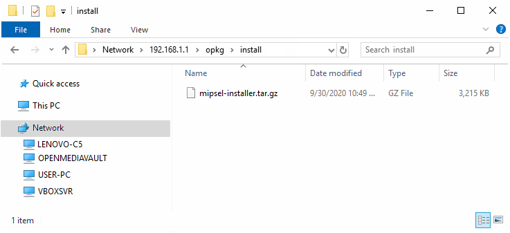

    Use a file manager to connect to the drive via the network (in Windows, you can use Explorer). In the router's settings, the SMB server application must be enabled in advance to access USB disks that you connect over the network.
    Create an install directory in the root of the disk partition where you put the file mipsel-installer.tar.gz.

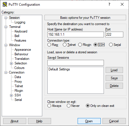

  7. Download the PuTTY terminal program for SSH and Telnet.
  8. Start PuTTY, select the SSH connection type, type the router's IP address in the Home segment (192.168.1.1 by default), specify port 222 and click Open.
    See the Terminal program for Windows article for more information on working with PuTTY.
    Port 222 is used if the SSH server component is installed in the router. If it is not installed, use port 22 to connect to Entware.

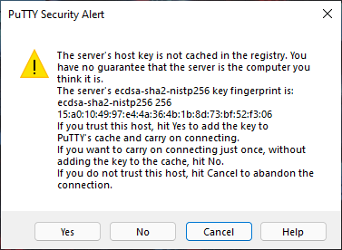

    Confirm adding the security key to the PuTTY cache to establish the connection.
    When booting up, confirm login by pressing Yes.
